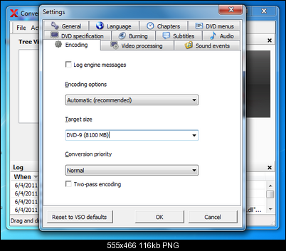

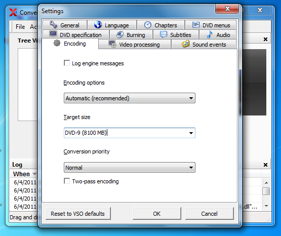

  23. Originally Posted by cowboyup910 View Post
    Nope, if you want the best output leave on automatic and allow the encoder to work properly to produce the best result. Don't be overly obsessed with output size but rather output quality.
    I think you are confusing two different settings. There is encoding and target size. Yes, encoding should probably be left on automatic. But, target size should be set to dvd-9 so that less compression is used. IF, and most the time it doesn't, the output is over 4.35 (sl disk) then you can use dvdshrink to compress just enough to fit perfectly onto a sl disc.
  24. Click image for larger version
    Sorry forgot to upload with last post.

  26. Originally Posted by cowboyup910 View Post
    Your changing the output to DVD9 just so that your output size is closer to filling a DVD5.
    No, I'm changing the output to dvd9 because my eyes tell me the resulting picture on my tv looks better then when outputed to dvd5.
    I've done it both ways. Leaving it on dvd5 creates too many compression artifacts for my liking.
