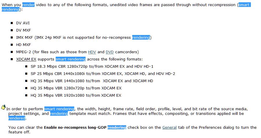

    Check "smart render" in Vegas help. Vegas Pro 9 does the above. Version 8 does most of these.

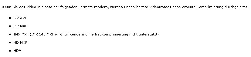

  6. This is the list of supported file types in Vegas Pro 8 (german help file). MPEG 2 is missing. Is that the reason?

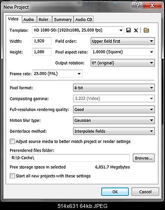

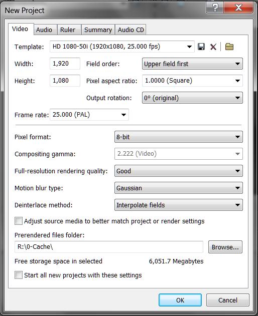

    HDV is MPeg2. Try modifying the HDV project template to 1920x1080i (square pixel PAR). This works in Pro 9.
    You will know it is working when the preview window goes black and shows "No Recompression Required" during render.

  9. I have used exactly these project settings. No success.
    I have tried Vegas Movie Studio 9 Platinum instead. Same poor result.

    It might make a difference to start with the HDV project setting before making changes.
    http://www.kiva.org/about
  11. When I change the project settings to „HDV“ and change the resolution to 1920 x 1080, Vegas automatically switches to the template „HD 1920 x 1080 25i“.
