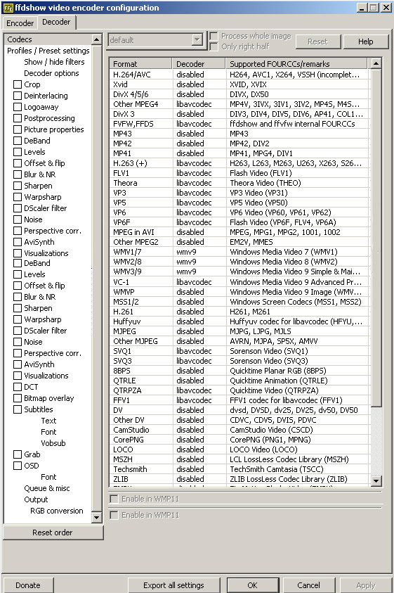

    All you have to do is simply open the file in VirtualDub like you normally would. In case your file doesn't show up, select 'All files (*.*)' from the file type list and after selecting your file, select 'DirectShow input driver' from the file types list.
    When installing ffdshow, only configure VFW encoders...

    You don't need Virtualdub-MPEG2 or the other programs from the Virtualdub Tools page. All you need is Virtualdub and the input plugins.
    If you installed the plugins pack then the FLVinput Driver should already be there. I would've installed the updated drivers. Make sure you delete the MP4 plugin or it will conflict with the QT plugin. You'll also need the updated Directshow Input Driver since the old version is buggy...
    http://forums.virtualdub.org/index.php?act=ST&f=7&t=15093
    Haali Media Splitter
    http://haali.su/mkv/
    ffdshow (to open files that Virtualdub does not support)
    http://ffdshow-tryout.sourceforge.net/
    If you're installing 32bit codecs in 64bit Windows 7 then you can't just right click the .ini and install. You have to install to the SysWOW folder.
    Installing the 32bit version codec on Windows 64

    DarrellS, did everything as you have told me to. Ran VirtualDub and tried to load some videos too, but except for mpeg1 and mpeg2 , I was not able to get any work.
    For files with Xvid.avi I get this massage-----
    Could not locate decompressor for format 'XVID'(unknown)
    VirtualDub requires a Video For Window (VFW) compatible codec to decompress video.Direct Show codecs such as those used by Windows Media player are not suitable.
    For FLV ----Virtual Dub error massage states.
    Unable to locate a video codec to decompress the video format 'FLV1' (unknown).
    I thought with ffd show we were supposed to get over this problem,or is it because of some other reason.

    Just as a side note - ffdshow beta 7 is slightly outdated. It's based on rev3154, I believe, from December of last year. The latest build of ffdshow is rev3507 (2010-07-07), more or less. If you'd rather have the more recent version, just visit VideoHelp's Tools page for ffdshow (which should be auto-linked in this post, already), and click on "Download (direct link)."
    You'll need to enable ffdshow's VFW decoders for Xvid and FLV1, among others. (I may not get this entirely right, as I'm sitting at a computer that doesn't have ffdshow installed, at the moment.) Go to your Start menu, find the ffdshow folder, and click on VFW decoder configuration. Make sure 'Codecs' is highlighted in the pane on the left-hand side of the configuration window. In the list on the right, look for 'XVid' and 'FLV1', and set their decoder dropdowns to something other than 'disabled.' Both should probably use 'libavcodec,' I think.

    You need to install the XviD codec. I would also install DivX, DivX 3.11, X264VFW and WMP9VCM
    You need to configure ffdshow to open all the files that Virtualdub will not open natively. That's why I asked you to look at the jpeg I posted. It has...
    Other MPEG4
    FVFW,FFDS
    H.263
    FLV1
    Theora
    VP3
    VP5
    VP6
    VP6F
    VC-1
    SVQ1
    SVQ3
    QTRPZA
    FFV1
    set to open with Libavcodec
    WMV1/7
    WMV2/8
    WMV3/9
    to open with WMV9
    You can either get to the VFW configure from Start > Programs > ffdshow > VFW Configuration or
    Virtualdub > Video > Compression > ffdshow Video Codec > Configure.
  30. Member s_joy09's Avatar
    Mar 2010
    Dhaka, Bangladesh
    Thanks DarrellS , you've been great My VirtualDub is working properly now.
