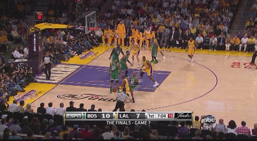

  1. I encoded a 720p/30fps source with CCE for DVD playback and I end up getting jagged lines every time. Look at the 3-point line in the picture below. When I play it back using Windows Media Player, PowerDVD, or VLC player on my PC the problem doesn't appear. However, when I author the video and burn it to a DVD I get those broken lines when I try watching it on my TV. In CCE I made sure that the progressive flag was tagged and set the block order to zig-zag. The result I get is a 720x480 16:9 progressive image with a Top Field First scan order (according to Mediainfo). Could this be a problem with the video or my TV? I'm playing it back on an old plasma Panasonic TV (not HD). Here's the Avisynth script I use for CCE.
    LoadPlugin("DGAVCDecode.dll")
    AVCSource("Source.dga")
    Colormatrix(mode="Rec.709->Rec.601")
    LanczosResize(720,480)
    ConverttoYUY2()
    If the problem is my TV, I'd like to some how still get rid of those jagged lines. If it's not my TV, can someone please tell me what I'm doing wrong? This is bothering me to no end. I'm willing to post more of my settings on CCE or anything else if needed.

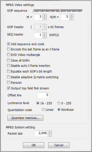

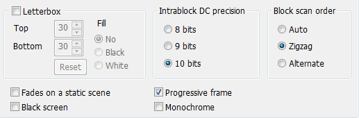

    I then send this script to CCE-SP2 using these settings:
    Advanced Settings
Name:	CCE-SP2 Advanced.PNG
    Picture Quality Settings
Name:	CCE-SP2 Picture Quality.PNG
    For Picture Quality Settings, I've also tried checking both alternate and zig-zag while unchecking Progressive frame. I've even tried converting it to interlaced with avisynth adding to my script ChangeFPS(59.94), AssumeTFF(), Separatefields(), Selectevery(4,0,3), and Weave() while checking alternate and unchecking Progressive frame in CCE. None of these methods have worked. I'm connecting my DVD player through component to my SD TV. I don't have HDMI or an HDTV.
