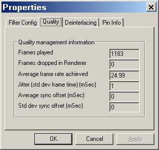

  2. Try playing the video in MPCHC. While the video is playing right click on the screen and select Filters -> Video Renderer. Exactly what you see will depend on what renderer is being used, but if you flip through the tabs you'll probably see a real time frame rate report. It should match the frame rate of your video:

  3. If the rip lags and the MKV lags then the problem has to be with the rip. That's the only logical conclusion. Try ripping with some other program. Does DVDFab HD do Blu-Rays?
