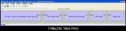

  11. You can build a graph to do it with GraphStudio and ffdshow's audio decoder.
    Enable ffdshow's Dolby decoder.

    Install GraphStudio (or GraphEdit) and ffdshow. Make ffdshow your default AC3 decoder. Then drag your AC3 file onto the GraphStudio window. It will automatically build a graph to play the file. You don't want to play the file so delete the audio renderer at the far right. The last filter in the graph should now be Ffdshow Audio Decoder. Right click on it and select Properties. In the Propreties dialog turn on the Dolby Decoder. In the Mixer section set the Output Speaker Configuration to 3/0/1 Surround. Close the dialog. Back at the main window select Graph -> Insert Filter... I added WAV Dest (builds WAV file format, comes with GraphEdit9) and File Writer (writes the file). You may need to connect the two filters to the graph (drag from the output pin of one filter to the input pin on another). Then press the play button in the VCR controls section.

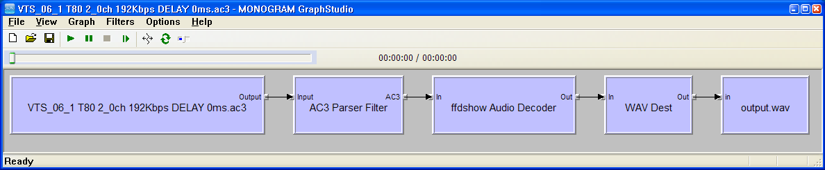

    OK I finally had some time to check this out. This is what my window looks like:
    When I chose the file writer plugin, it asked for an output name so I just entered "r1.wav" in the dialog box. Is that right?
    Anyway I press Play but nothing seems to be happening. What should happen, will I get a 3-channel WAV file?
  23. When you press the Play button it should turn gray and the Stop button should turn red. There is no other indication the program is working (except the output file is created and growing, if you look at it). When the buttons turn back to their original colors the conversion has completed.
    You should use the Browse button in the File Writer filter to make sure you know where the output file is created. Otherwise you may have to hunt for it.
    The WAV file will have whatever number of channels the source had or whatever number ffdshow was set to remap it to. You can examine any of the filters, input pins, or output pins by right clicking on it an selecting Properties.
  24. Thanks again, that worked. Seriously; big thanks.
