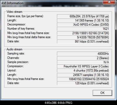

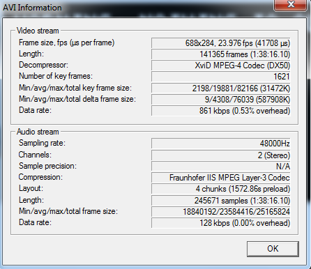

    1st) Click image for larger version
    This Movie was unique nothing worked with this if i do full compression mode and compress - not compress it nothing worked. Everytime the audio was 2 seconds forward of video. But when i made it with Direct Stream Copy. It worked. The audio synced with the video.

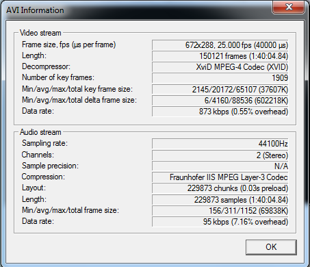

    2)Click image for larger version
    This Movie i did with no problem Normal Full Processing with audio and video and using lame MP3 compression

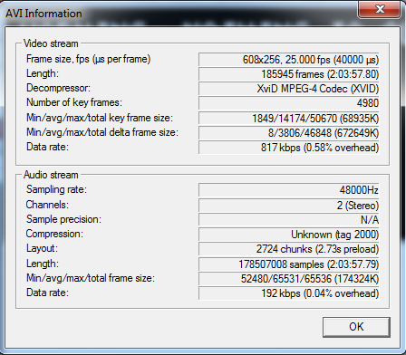

    3)
ID:	2642Click image for larger version

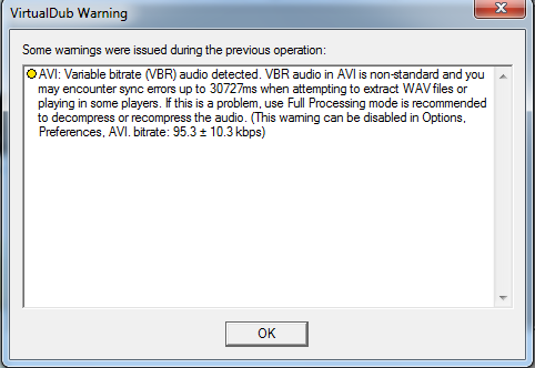

    This Movie was done with Full Compressing mode both Audio and Video with Lame MP3 compression. But i don't understand the first error box that pops up.

  5. Always Watching guns1inger's Avatar
    Apr 2004
    Miskatonic U
    Open the file in AVI Demux. If you get asked to rebuild the time map, say yes. Re-encode from there.

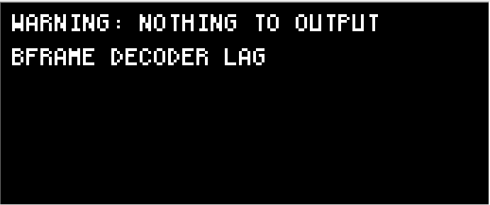

    Respected: jagabo, guns1inger and redwudz
  7. Click image for larger version
    Does this pic has to do something with the audio problem. I get this when i put the original AVI.
  8. Mod Neophyte redwudz's Avatar
    USA
    No, that's a video error. But you can just crop out of the first frame of the file to get rid of it. It's caused by videos encoded with b-frames, without packed bitstream, and VFW's inability to handle out of order frames. (I think I stole that quote from jagabo )
    What I do with VD Mod when I run into MP3 VBR (Variable Bitrate) audio is to save out the audio track with full audio processing as a WAV, then drop that into Audacity and re-encode it to CBR (Constant Bitrate) MP3, then mux it back with the video by adding it in the VDM audio window. Probably better ways to do it, but that works for me. VD doesn't handle VBR audio very well. AVIDemux does it better.
    I'm guessing that some programs like VDM can't read the length of VBR audio correctly, and that's where the sync error comes from. VBR audio is commonly (mis)used by coders on the web to save a few bytes on the video filesize, but it often causes problems when re-encoding.
  9. I have an audio compression of Lame MP3 can i use that to convert to CBR..
    What is audio Stream and full audio process stream
    Nov 2002
    What version of Virtualdub are you using? The new versions should handle VBR MP3 without any problems. Just turn off the error message or ignore it.

  13. Hmm I want to Mux new 700 MB movies with subtitles and watermarks and i found everything ok. Except audio part goin haywire.
    I also get the damn bframe decoder error.
    I think direct audio stream is best but bframe decoder needs treatment. I don't want it to be showed for split second when i dub and see the movie. Any solution.

    If you are re-encoding anyway, use avisynth to load the file and this message will probably not appear. Use a simple script
    DirectShowSource("fullpathtofile")
    Should be enough
