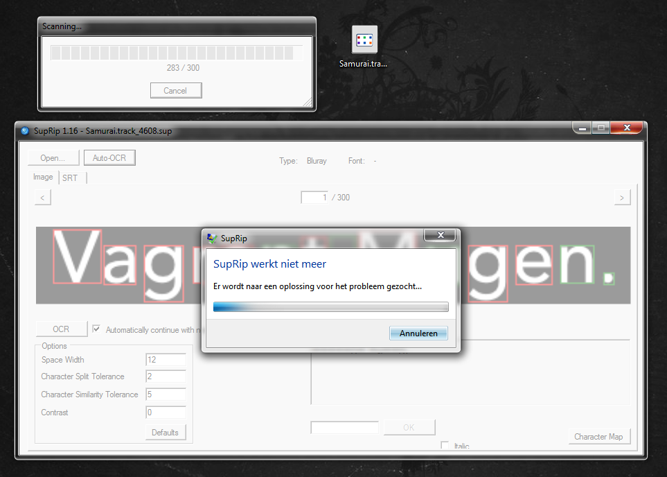

After everything is done i need to rip the subtitles from Bluray disc and then convert to SRT.
What i did :
1: Rip the PGS with tsMuxerGUI
2: Open the file in SupRip 1.16 {Latest Version}
3: OCR the subtitle and when i come to end like 20 lines left, the software crashes...
I tryd to use different subtitle but its all same, everytime i come to the end it crashes..

In looking at the visual you provided, it appears that the program settings could use some tweaking. Mostly I use 10, 1, 200,5.
But you would need to try different settings than what you have. The visual shows that it is not recognizing any of
the letters and that may be why it's crashing.
Also you can try re-downloading the program and starting over. You can also try deleting the learning files.
They may have become corrupted. I believe that the file is in documents and settings suprip temp folder
The program SupRead can also convert Sups to srt.

Hai Tony,
Thx for helping me out, but still same errors.
But i found a way how to work with it, it takes a bit longer but its ok.
2: Open the file in BDSup2Sub and concert it to sub/idx
3: Then open the sub/idx file in SubResync [VOBSUB]
Thats way it works, but the "i" has some big problems.
The way I've been doing it is change the resolution in BDSup2Sub to 720x480 then export as ifo/sup. Load into DVDSubEdit. Do automatic OCR and export as .srt
Sometimes it comes out very clean. Sometimes not. Usually I search the .srt file for the underscore character '_'
If there are too many lines with '_' (the line usually looks like "_-!__%&_" instead of English text) to clean up manually,
then I try to find the .srt with the right run time someplace.
If none of that works, then I export as idx/sub without downsizing the resolution, and just burn the subs in. If fact I'm doing more and more burning in since my WD set top box has a tendency to get .srt subs out of sync. BD Rebuilder latest beta has an .avs filter dialog you can use to burn in subs with very fast encoding time if you're not a stickler for maximum video quality(of course if you are a stickler then you can use 2 pass mode.)http://milesaheadsoftware.org/
