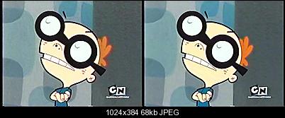

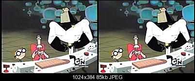

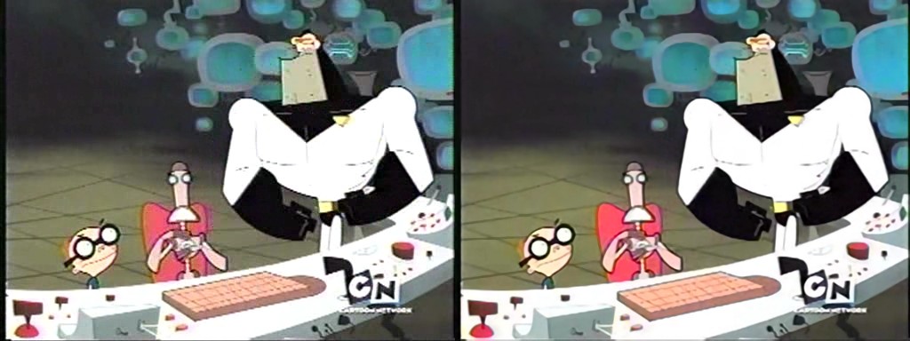

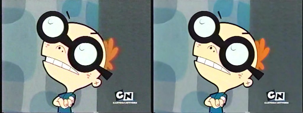

  14. Originally Posted by lordsmurf View Post
    Would you look at this file: http://www.lordsmurf.com/sample.avi (273MB, Huffyuv AVI, 30 seconds footage)
    The sample has quite a few scenes in the 30 second span, so good sample.
    Any tweaks to maybe remove even more edge noise?
    I pushed the depth=6 to depth=16, and it seems to have helped.
    However, I'm not sure if other harm is being done. Granted, the source sucks. (Not my fault.)
    But as I understand it, the filter "thins" content to aid the antialiasing filter. Might that remove detail?
    Or maybe the low quality (VCD-like, but not quite as bad) is already lacking in details?
    Yes it can be harmful, and the awarpsharp/antialiasing stack isn't for "edge noise", it's more for fixing broken lines
    All AA filters remove fine detail, but you could argue that this animation barely has any real details. AAA() adds a blur through unfilter, so you want to be careful with that one , unless "softer" is the wanted effect (this is usually ok for simple animations, but might not be for modern, higher quality , high resolution animation)
    Awarpsharp2 thins the line width, so when stacked with AA filters, the AA filter can "detect" poor animation lines ; In some animation, thicker lines may have evaded detecting, but in this way you can sometimes "fix" these broken lines that either have been wrecked by poor compression or bad processing (deinterlacing). Be careful about lines that are thin already, they will be destroyed. This is why sometimes people apply it in multiple stages with low settings , darken/thickening the lines between each stage with fastlinedarken or toon. If you've raised the "depth" setting make sure you check in other scenes, where thin lines might have been destroyed. Unlike the example at the beginning of this thread, I don't think they need to be thinned much here to fix the jaggies, santiag or other comparable filters should fix the aliasing . The lines are fairly thin to begin with in this source, and IMO stacking the same filters is more destructive in this case
    But you're referring to edge noise , correct? ie. the MPEG compression artifacts, mosquito noise, gibbs effect, dct ringing etc.... not the aliased or broken lines which are handled ok by santiag (or other AA filters) ?
    MCTD has an edge cleaning mode that targets this area through masks (edgecleaner is another filter that attempts to target noise around edges only), and you can use TTempSmooth to stabilize the background fluctuating noise
    AVISource()
    ConvertToRGB24() #source was RGB32 with dummy alpha
    Santiag(2,2)
    ConvertToYV12()
    Toon(0.5)
    MCTemporalDenoise(settings="medium", EdgeClean=true, ECMode="dfttest().dehalo_alpha()", strength=25, chroma=true)
    TTempSmooth(maxr=4, lthresh=16, cthresh=4, strength=4)
    Notes: the "strength" in MCTD refers to the contra-sharpening strength, not the denoising strength. I suggested a lowish value, because there are oversharpening/halo artifacts in the source, so you can add a general dehalo filter, but that will blur away even more details. MCTD has TTempSmooth aslo (it's a mega function), but I prefer to break it out, so you can control the parameters better. If you might find chroma noise still bothersome, you can stack a chroma noise filter

    Deblock() # remove macroblocks
    ColorYUV(cont_u=50, cont_v=50) # increase saturation
    ChromaShift(C=-2) # shift chroma left by two pixels
    AAA() # clean up some thin lines
    Santiag() # clean up more thin lines
    Deen() # remove edge noise
    MergeChroma(awarpsharp2(depth=48)) #sharpen chroma
    Before on left, after on right:
