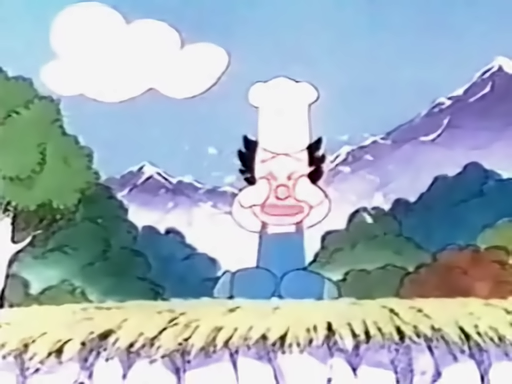

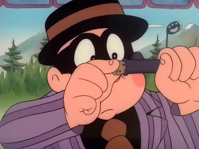

    Hello,
    I'm wondering is it possible to improve the image quality anime that is located on the top to be the same quality as the same anime bottom ?
ID:	2601 Click image for larger version

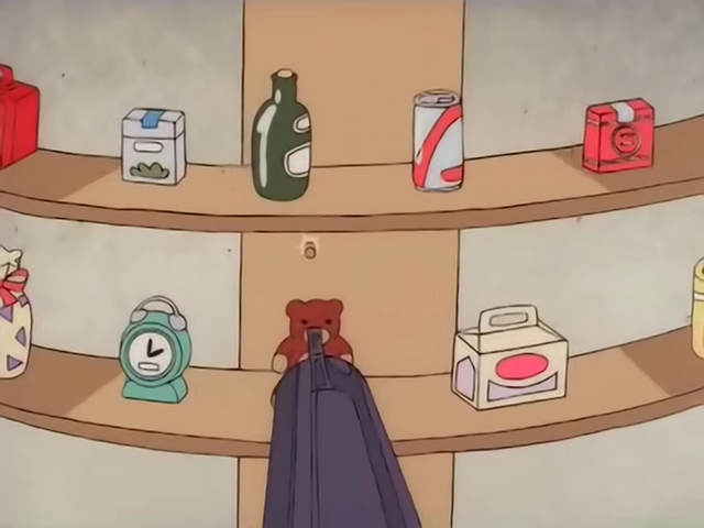

  2. The bottom image is oversharpened. It has bad halos around all sharp edges lines. But if that's what you want, yes, just about every editor has the ability to sharpen or "enhance edges". And they all have the ability to adjust the brightness and contrast too.
    Your sample AVI also has the problem of having been deinterlaced. That leaves jaggies on all near horizontal edges. You won't be able to fix that. If you can get ahold of the video before it has been deinterlaced you will get much better results.

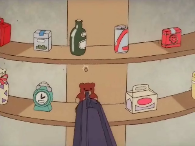

  4. Originally Posted by jagabo View Post
    contrast too.

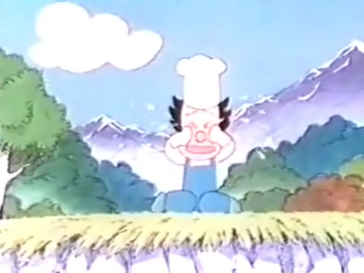

    I agree for the most part, and maybe you can't "fix" it but you can certainly improve upon it.
    I think the jaggies/aliasing are the most distracting artifacts, worse than oversharpened halos
    in the supposedly "good" picture.
    But the source has other issues, like duplicate frames, bad pixellated frames, and there was a
    frame out of order as well. I agree with the comments above and would re-rip this source and
    start all over and use a better deinterlacer this time. The treatment I proposed below is quite slow to process, and I never addressed the dupe or out of order frames in this script - it's just a demonstration that a subjective visual improvement is possible.
    AVISource("sample.avi")
    AwarpSharp2(depth=6)
    santiag(strh=2,strv=2)
    AAA()
    Toon(strength=0.6)
    DFTTest()
    LSFMod(strength=50)
    Levels(0,1,245,0,255,false) #You could use SmoothLevels instead, but your bitrate requirements will go up from the dithering
Name:	10 original.png
Name:	10 script.png
Name:	184 original.png
Name:	184 script.png

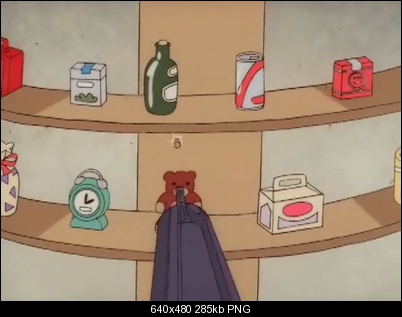

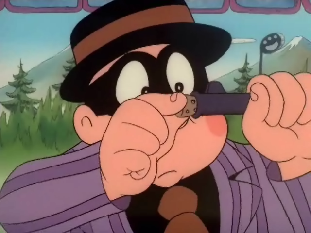

  9. Thx. How well did they work on the next shot?
    I imagine it just leaves gaps in the lines.
    Which shot / frame # is that?
    313?
Name:	313 script.png

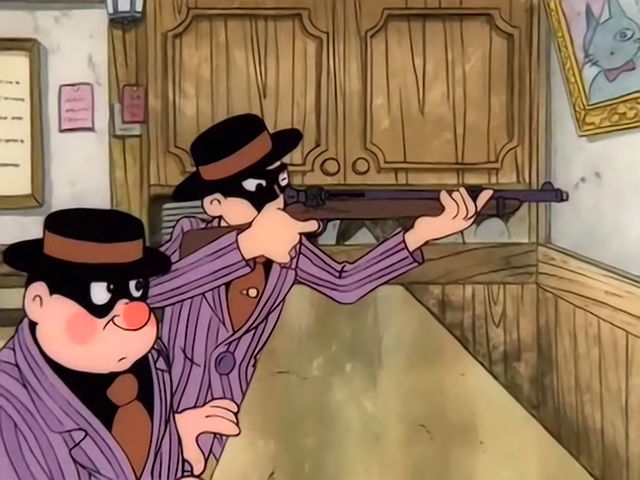

    AVISource("anpanman.avi")
    Levels(10,0.7,255,0,255,false) #or use smoothlevels
    DFTTest()
    Toon(strength=0.8)
    aWarpSharp2(depth=12)
    LSFMod(strength=50)
Name:	1400 original.png
Name:	1400 script.png

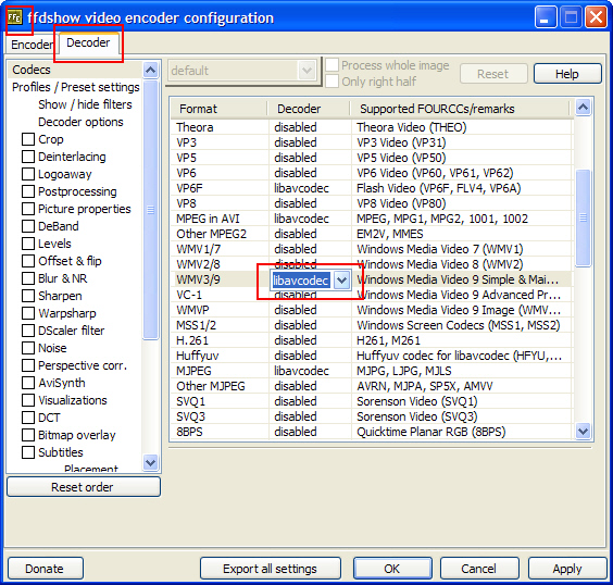

  26. Install a VFW decoder for the codec in question. Use GSpot to figure out what codec you need.
  27. Sorry there is something wrong with the code box on this website, it inserts "\" when there shouldn't be
    It should read
    Also, your video was WMV in AVI container, so you need to enable WMV in the ffdshow VFW configuration (yellow icon)

    Ok, i enable WMV in VFW configuration like this:
    http://img697.imageshack.us/img697/8859/enable.png
