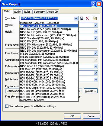

  11. Originally Posted by edDV View Post
    Also tell us your Vegas project settings since version 8 doesn't have a native AVCHD project.
    The following are my Vegas 8 project settings. I use NTSC.

  13. ^ This sample isn't interlaced , it's 1080p30
    Progressive material can be resized with a straight resize. Interlaced material requires special treatment. If you're happy with virtualdub, you could use that. Another option is to use avisynth to resize. Vegas will work fine as well.
    Since you're already familar with CCE, you can just use that to make SD DVD-Video . Other easy to use options would be AVS2DVD or multiavchd
    Note 480p30 DVD's can be problematic in some players (it's flagged as 60i , but some players may not handle it properly - they all can handle 3:2 pulldown, but not all have 2:2 pulldown compatiblity) , and 720p30 (or 1080p30) is completely out of blu-ray/avchd spec.
    For HD you would normally frame double (i.e. duplicate every 2nd frame) to make it "fake" 720p60 to make it compliant. The problem with this is it's less efficient (you're coding all these duplicate frames) but I've seen retail blu-ray's done this way. Some people have been able to apply 2:2 pulldown or get the muxer to to take 720p30 footage for blu-ray - but this is very dicey and doesn't work in all players either. The safest way as of now is to frame double
