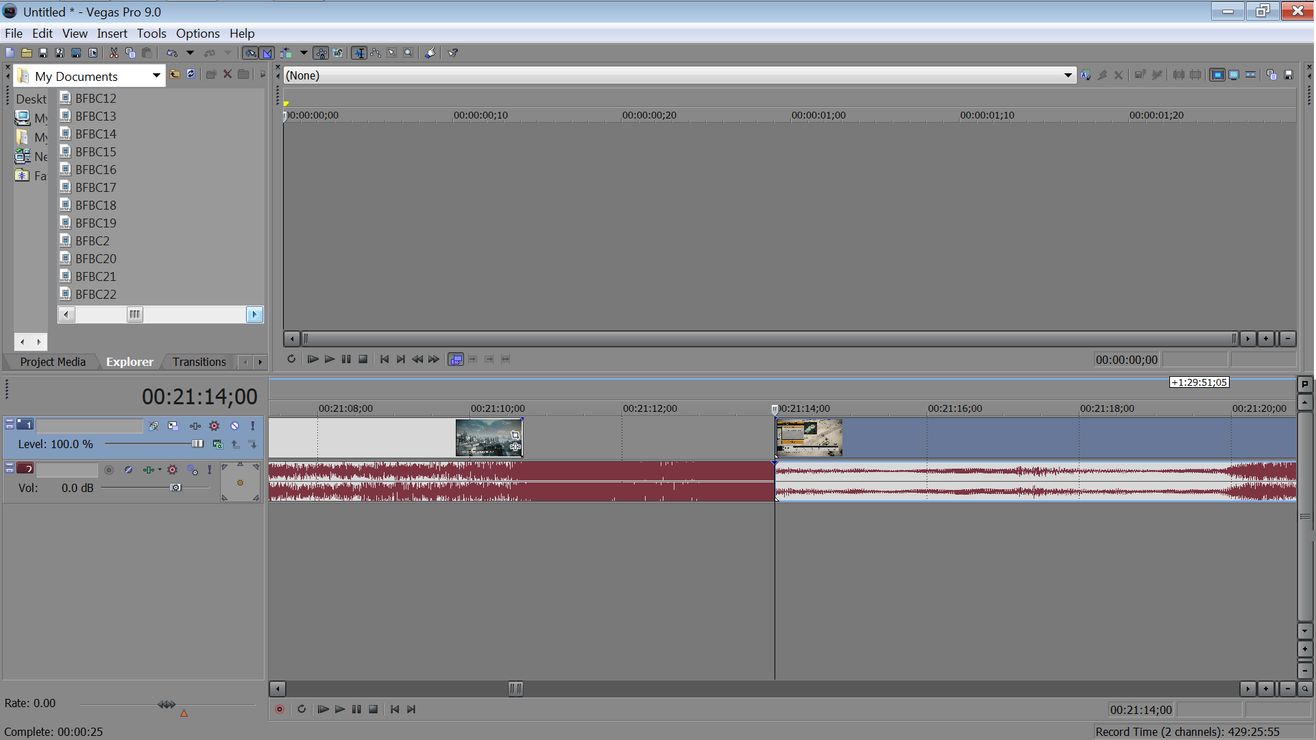

    Im having a problem with captured video, when I'm editing the video I'm finding the audio is out of synch but only on the last few minutes of the capture. Anyone else experiencing this problem?
