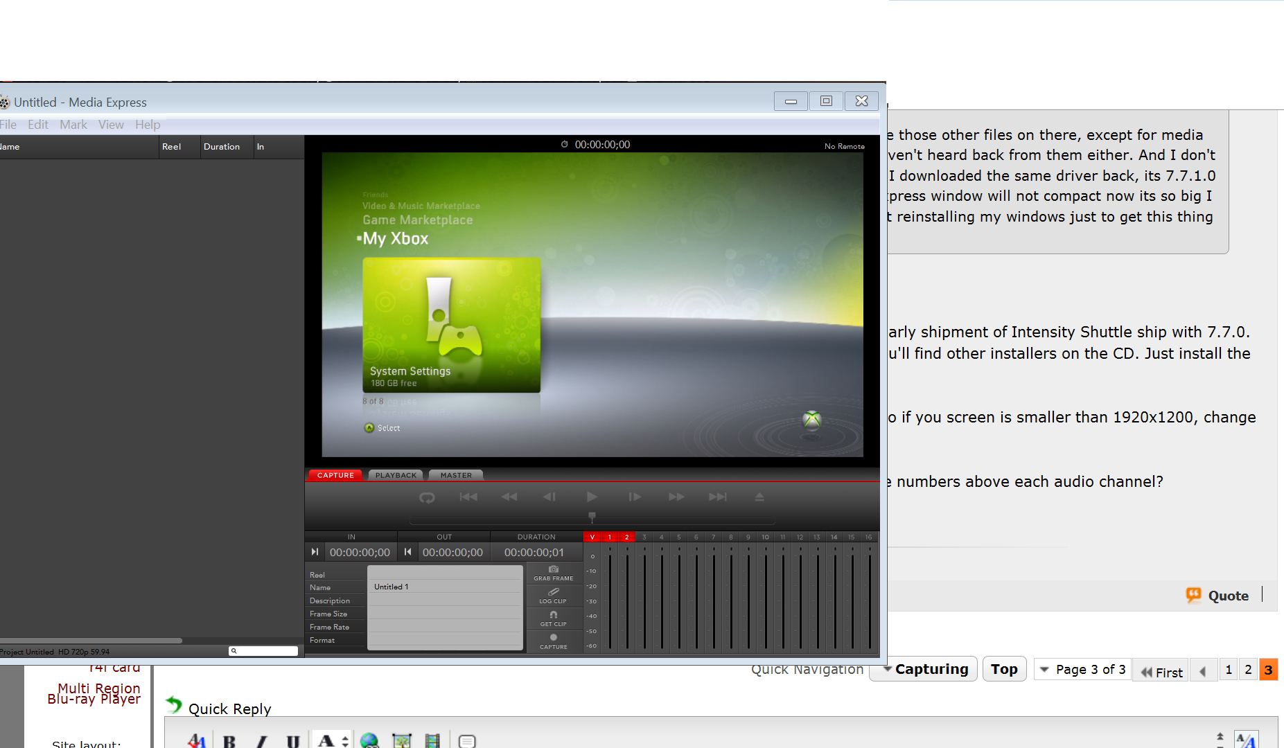

    Hi,
    I just want to make sure everyone's on the 7.7.1 driver as some of the early shipment of Intensity Shuttle ship with 7.7.0. We ship a single CD with drivers for all our other products, that's why you'll find other installers on the CD. Just install the one you need and ignore the others.
    Media Express is designed to work in a 1920x1200 or 1280x800 screen so if you screen is smaller than 1920x1200, change the size of the interface from the menu bar.
    Did you enable the audio channels you want to capture by clicking on the numbers above each audio channel?

    [Attachment 2711 - Click to enlarge]
    Yes both audio channels are highlighted (picture above) I have my resolution at 1080p on my pc but it works if I have windows classic theme on not one of my custom ones I have full picture and audio on my AV channel on my television running through the shuttle but no audio on my pc or in captures Ive taken.
    Ok I have seen my mistake and come back to edit this ... You can't have audio on play back unless you are still on the av channel your 360 is on I have been trying it through my pc on playback but as soon as i clicked playback on my av channel i could hear all audio from the capture I just didnt realize that was necessary.

    Originally Posted by Kristian Lam View Post
    Ok cool. So the issue with FME is that the Directshow filters were not registering correctly during the installation. Apologies about that. We will fix this in the next driver update but this can be manually registered via the command line. I'm don't have access to a Windows machine right now but if you navigate to the location of the Blackmagic Desktop Video directory within Program Files, you should see 2 files
    1) decklink.dll
    2) decklink64.dll
    Type "regsvr32 decklink.dll" <enter>
    Type "regsvr32 decklink64.dll" <enter>
    That will manually register the filters. Restart FME if it was open when you typed the commands and you should be good to go.
    I'm gonna try this tonight. If it works!!
  26. Please Help me i keep getting the error for the video codecs so i get audio but no video in the Media Express i just got a new
    USB 3.0 pci card today. really need help.
  27. Originally Posted by AEYST View Post
    1) decklink.dll
    2) decklink64.dll
    I can confirm this works. Awesome!
