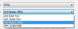

  11. I couldn't find another place to change compress/uncompressed settings but i'll look some more. BTW i named my machine ELEET RIG as a joke lol.

    What is DPX 10-Bit RGB? That's new.
    Anyway, "AVI Motion JPEG" is compressed and "AVI 8/10 Bit YUV is uncompressed so use JPEG (less bandwidth).
    In your image, what comes after HD 1080i 60 in the list? No 480p listed?

  13. After the 1080i 60 its all the 720p 50 fps, 59.94. 60 fps.
    as for the audio channels i think this is what you're talking about in the picture you can click on the numbers and stuff and i believe those are the audio channels. (i'm not so experienced in the world of video yet.)
