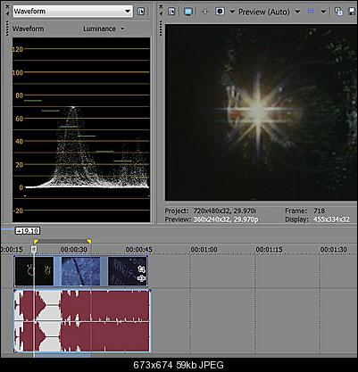

    Black is either correct or crushed. I suspect it is being crushed by your capture card* to 7.5 IRE (digital16). You can see original blanking as the dot below the zero on the waveform monitor and also on the right side. NTSC-J should have black at blanking level. I suspect your card is crushing 0-15 digital levels to 16. Compare a direct analog VCR playback to a CRT TV and compare to the digital copy. Is low gray shadow detail being lost?
    White is low for the clip provided. You need to search the tape for a clip with both black and peak white. Not all video goes all the way to full 235 white. It is a director's decision. In the broadcast world they put a representative color bar on the tape header to identify black and peak white per the directors intention. The actual program might lack a peak white or a full black. The playback or dub technician just sets transmission levels to the color bar.
    Also, your audio levels show too hot and look clipped.

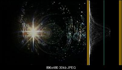

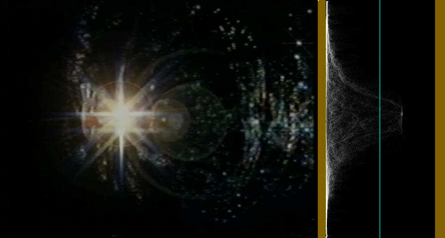

  5. If you don't have Vegas you can use AviSynth's Histogram() to view levels. You want the darkest areas to just touch the brown bar on the left and the brightest areas to just touch the brown bar on the right. A frame from your MPEG file:

    The black level is correct (although, it's possible that there where darker bits that where crushed somewhere along the line) but the white level is too low (assuming that bright spot was supposed to be at full brightness -- in the sample that spot and the text a few frames later are the brightest objects).

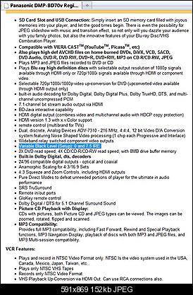

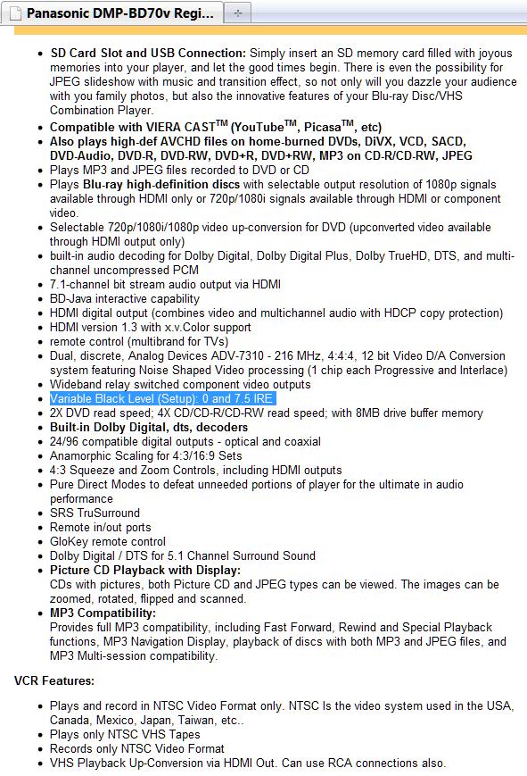

    Interesting combo player. Ideally you would have an NTSC-J VHS calibration tape. I wish I had one of these for a weekend to test. From the specs it looks like the VCR is separate from the Blu-Ray player. That is unless they share analog output circuitry. Do the Blu-Ray/DVD player or SD card stills output on the composite (yellow) or S-Video outputs? If not the VHS player probably connects directly to composite out (no A/D, D/A).
    Does the VHS playback show on the S-Video output or analog component output?
    The specs do show that VHS output can be upscaled to HDMI. I'd test to see if the upscale shows up on analog component as well.
    In the Blu-Ray player spec they show an interesting feature -- "* Variable Black Level (Setup): 0 and 7.5 IRE" Does this do anything to the composite, S-Video or analog component outputs during VHS playback? Does it affect HDMI VHS upscale black level?
    http://www.world-import.com/Panasonic_DMP-BD70v_Region_Free_Blu_Ray_DVD_Player_with_VCR.htm
