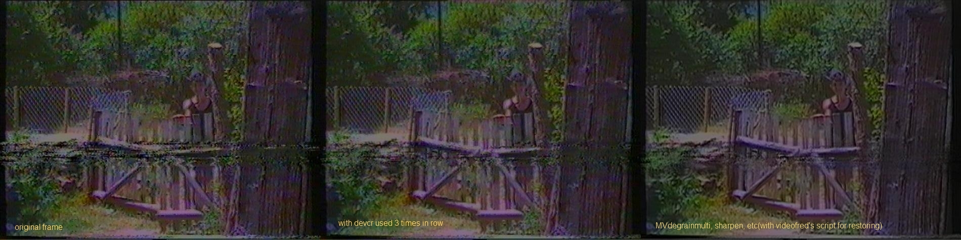

    Hi, i did some experiments with devcr today, and.. i kind of like it
    I'm still(over a year) trying to find the best way to fix some ugly vhs video, and from time to time i come back to it.. trying something new.
    Today i did this, i used devcr 3 times in a row with
    fixedclip = deVCR(myclip,0)
    and although "resizing the clip to 16 pixels wide is more than enough" .. i used 32pixels resizing
    And then used videofred's script for 8mm film restoring( mvdegrainmulti with 6 reframes and denoising_strenght=600 etc)
    I like what devcr does, and maybe 3 times is to much but... it removes more of the lines than when used 1 time..

  14. I would call that a definite improvement pirej . Your "noise band" is fairly thick , so there isn't much salvagable information in that area, and if I'm not mistaken, the filter works spatially, not temporally .
    Is that screenshot representative of the repair you're getting (with different frames? )
    Did you try tweaking the settings for DeVCR to see if you could get some different results ?

    Yes , the improvement is constant, some frames are even more improved.
    Actually.. im not familiar with "spatially/ temporally things" so i dont have the answer , i allways do it by some mine logic and testing(a lot).
    What would(could) you tweak in devcr?? Is it the Grayscale levels or what?

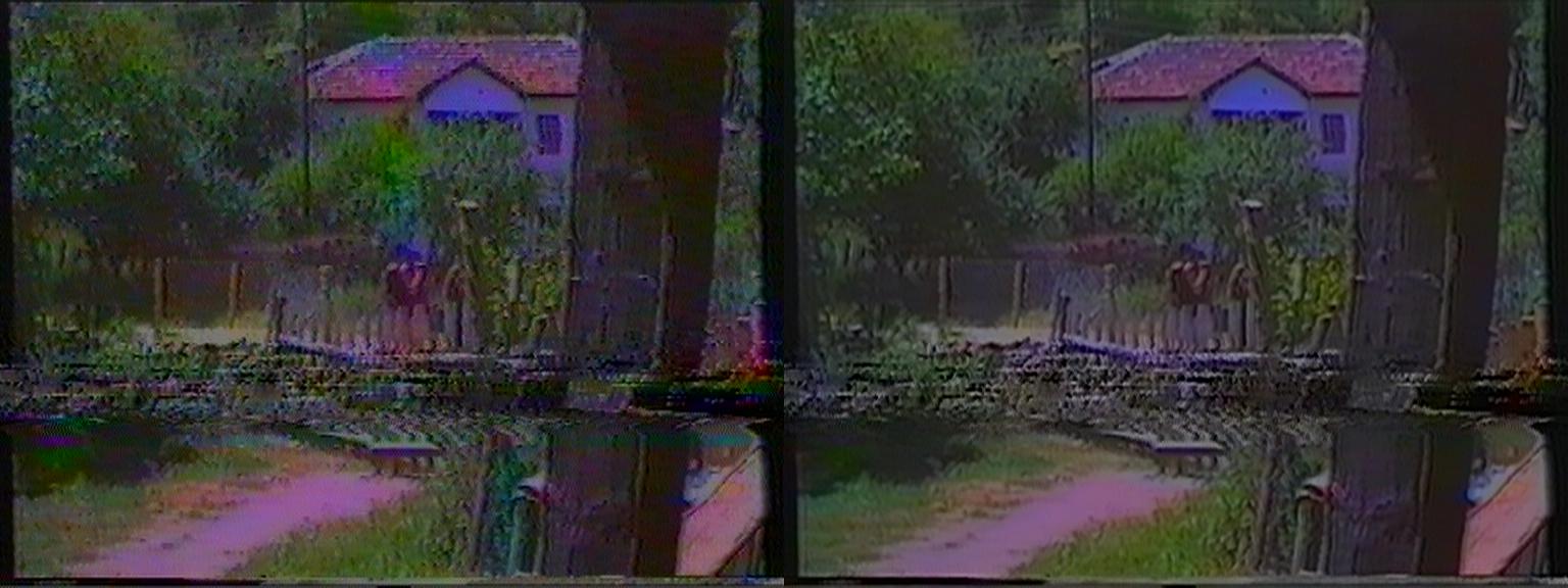

    Here is another frame that is REALY "damaged".. and the restored(in the same order) one.

  16. spatial filter means its just looking within the same frame
    temporal filter means it looks at forward/backward frames for information ; many of the filters in video fred's script work temporally
    I don't know what you could tweak in deVCR, I never used it before ... I was just asking to learn
    IMO, it's videofred's script that's is doing the "heavy lifting" here, deVCR is only making a minor difference . For example, what does that last screenshot look like without deVCR (only videofred's filters) ?

    Originally Posted by pirej View Post
    Today i did this, i used devcr 3 times in a row and although "resizing the clip to 16 pixels wide is more than enough" .. i used 32pixels resizing
    What exactly do you mean by 3 times in a row? Maybe you can post your script?
    I have a tape with line going through most of it (pixelated, sometimes with dropout), probably like Lodivico's problem. Tried DeScratch but didn't seem to do anything. Tried DeVCR and also didn't do much, but I probably need to experiment (and maybe try DeSpot)..

    I meant something like..
    myclip = AVISource("C:\test.avi")
    myclip2=fixedclip
    fixedclipB = deVCR(myclip2,0)
    myclip3=fixedclipB
    fixedclip3 = deVCR(myclip3,0)
    I'm not shore if it's a correct way of using it, but..
  28. Member spiritgumm's Avatar
    Jan 2004
    Thanks. Previewing it in AvsP shows some improvement. There's artifacts when things are in the motion, I guess from the interlaced fields. Did you have a problem with that?

    Everything was fine with that short part of my video, no artifact's, BUT on other parts of the video (with more motion) artifact's appear.
    So.. this is not the solution for me, its good only for some part's of the video.
    I'm looking for something different, but nothing effective so far.
