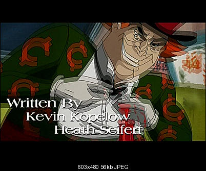

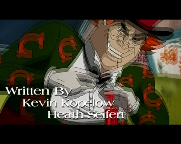

    I was expecting higher quality deinterlacing. What I ended up with was blended frames?
    What am I missing here?

  4. It works fine here with either (dss2 or ffvideosource) with that video sample above - no blending. Did you use the exact same script posted above? Delete the index created by ffvideosource and re-index it
    The problem with DSS2 is that it relies on your directshow filters, and you know the potential problems that can cause. It maybe why you are getting blends
    DGIndex is the most consistent and less prone to these issues and things like directshow problems

  7. Beware: DirectShowSource or DSS2 may be deinterlacing even before AviSynth gets the frames. I think that's what's happening in the sample image above (blend deinterlace).
    What colorspace the video is in after DirectShowSource or DSS2 will depend on what the MPEG2 decoder put out. Not always YV12.
  8. Originally Posted by jagabo View Post
