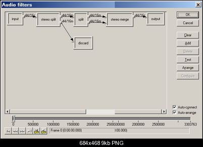

  2. You can use VirtualDub's advanced audio filtering to copy the right channel to the left channel then reencode the audio. Put Video into Direct Stream Copy mode so it doesn't get reencoded:

    On the Stereo Split filter, I don't know which is right and which is left. You'll have to figure it out for yourself.

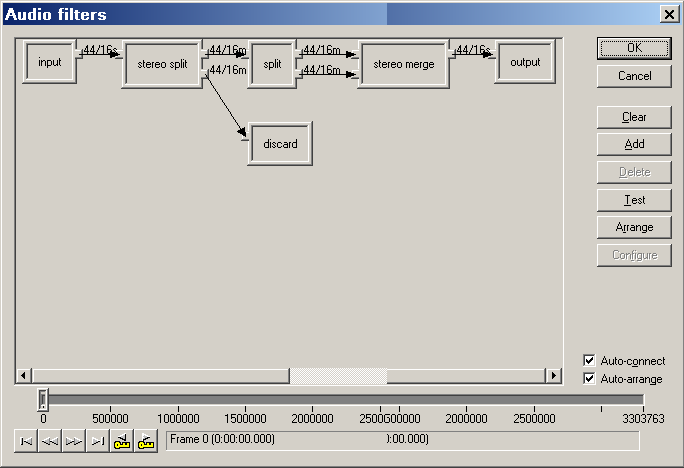

  3. Is there any other program that I could use to resolve this problem? I tried the advanced audio filtering like you suggested but mine doesn't look like yours does! I only have one 44/16 where you have two sets! I am also getting audio filter has unconnected input pin errors. Could you walk me though the process step-by-step please? I would really appreciate it! I'm sorry to be a pain! Thank you for replying back to me so quickly in the first place!

    I apologize! I see how you got it that way! I'll save it now and see if it works! Thank You!!!
    Thank you so much Jagabo! I did it with split where your discard was and discard where split was and it worked perfectly! I now have sound in both channels! Again, Thank you so much!!!
  7. You're welcome. It looks like I guessed the wrong way! Congrats.
