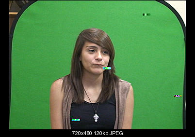

  5. edDV, thanks for the reply. I know my initial post was long, but I addressed several of your points (all good ones) and had already ruled them out. The capture works fine on two other computers so it rules out the camera, cable, and tape as he problem. I have also used different capture software on the problem computer with the same result so that should rule out PremierePro as the problem.
    Then based on other advice above, I disabled my RAID and tried capturing to a single drive and it didn't help. So, it can still be a 64-bit driver issue since the other two computers I tested the capture on were both 32-bit machines/software. As far as my editing computer, I recently built it myself for the main purpose of using CS5. Like you, I haven't seen this before and have checked all the things I could think of checking. Even though I've tried two different IEEE-1394 options (built in the front of the case and attached to the motherboard AND an add-on card in a slot), I still think this might be an IEEE-1394 issue since that is what is transferring the video to the computer. I have tried the newest IEEE-1394 drivers as well as the "legacy" driver based on recommendation from another forum and that didn't help either. I included a picture below to show exactly what the problem is and the fact that it isn't "major" but also not good.

    I'm out of ideas. I was going to suggest a different IEEE-1394 card.
    A glitch like that is probably due to a buffer overflow. As if the IEEE-1394 card isn't getting priority. Normally a desktop computer will have PCI bus mastering that isolates the IEEE-1394 to memory to SATA disk controller process from the OS background operations. Check in the CMOS setup that Bus Mastering is turned on.
