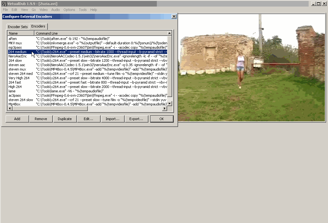

    Nov 2002
    I've been playing with experimental versions of Virtualdub which have an external encoder option that allows you to use certain CLI encoders.
    For FLV, you can encode with x264 and passthrough the mp3 audio. You may have to use null transform to crop the bottom or right side of the frame because the FLV decoder seems to add ten pixels to the bottom or right side. Usually the bottom.
    There is a tutorial on Virtualdub's forum for using the external encoder feature.
    Here are some sample encoder sets and encoder settings...
    Video Encoder
    x264
    C:\Tools\x264.exe
    --preset medium --bitrate 1000 --thread-input --b-pyramid strict --vbv-maxrate 2000 --cqm "jvt" --fps %(fps) --direct temporal --output "video.264" - %(width)x%(height)
    video.264
    Audio Encoder
    Aften
    C:\Tools\aften.exe
    -b 192 - "%(tempaudiofile)"
    %(outputname).ac3
    AC3 Passthrough
    C:\Tools\FFmpeg-0.6-svn-23607\bin\ffmpeg.exe
    -i - -acodec copy "%(tempaudiofile)"
    %(outputname).ac3
    MP3 Passthrough
    %(outputname).mp3
    NeroAac
    C:\Tools\NeroAACCodec-1.5.1\win32\neroAacEnc.exe
    -ignorelength -lc -if - -of "%(tempaudiofile)"
    audio.aac
    Lame
    C:\Tools\lame.exe
    -V6 - "%(tempaudiofile)"
    %(outputname).mp3
    Multiplexer
    MP4
    C:\Tools\MP4Box-0.4.5\MP4Box.exe
    -add "%(tempvideofile)" -add "%(tempaudiofile)" "%(outputfile)" -fps %(fps)
    * Delete output file before starting
    MKV
    C:\Tools\mkvmerge.exe
    -o "%(outputfile)" --default-duration 0:%(fpsnum)/%(fpsden)fps "%(tempvideofile)" "%(tempaudiofile)"
