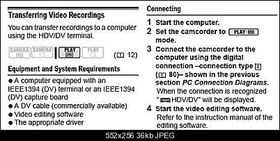

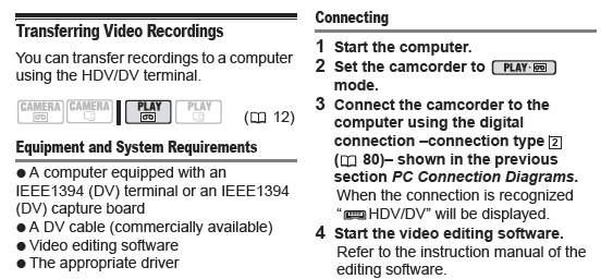

    Despite the fact that we were lead to believe firewire was hot-pluggable, many camera manufacturers (including Canon) strongly suggest or even state outright that their cameras should only be attached when both the camera and the PC are turned off. According to them, plugging the camera in when either the camera, the PC or both are on can fry the port.
    bullcrap. more old wives tales. from the latest canon hv40 manual. specifically states to turn both devices on first.
