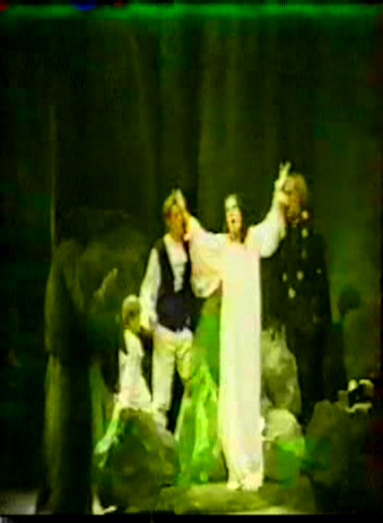

    I included a zip file that has the "A" point, the "B" point and the interpolated middle frame using default settings - you can see it's noticably blurrier and can see the edge morphing that I talked about earlier. Each interation after that will be even worse, because you are using that as new reference
    Hmm. The top and right border stains again, and in the damaged frames they're worse than the others. I think I should try chubbyrain2 and some basic denoising first (but not NeatVideo or anything in RGB, I want to stay in YUV as long as I can). I saw a note somewhere in discussions of mvtools that some initial denoising would help the interp process and prevent propagation of noise between frames/fields). Looks like you guys have set up a real workload for me.

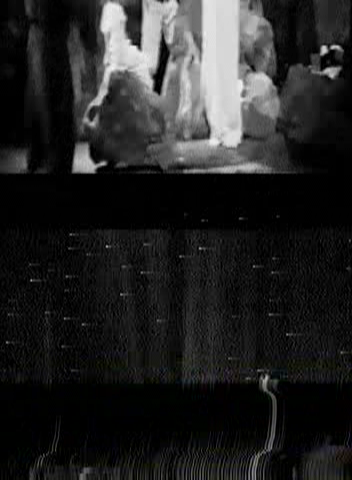

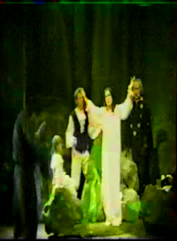

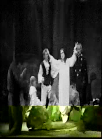

    I looked at that bad bad sequence more closely and here are a few more ideas you can try:
    I think you can salvage that black and white sequence (ie. colorize) it. You said you were having difficulty earlier, but a simple trick is to place the B&W frame on top, place a colored "reference" beneath and use "luminosity" transfer mode. It's easier to do in AE, because you can layer sequences and fix up with masks and motion tracking to align the frames, but you can do it in photoshop as well. It does a close match as is, but of course you can fine tune it. I can't find the equivalent transfer mode in avisynth's overlay
    http://avisynth.org/mediawiki/Overlay
    EDIT: I found the equivalent transfer mode, it's called mode="luma" when you use Overlay()
    Since you get better interpolation using "real" data and real frames, I think this can be improved even more (instead of using only 2 frames to interpolate 166 - the motion will look more natural and will align up with the audio more closely) . There are a few points in between (before the B&W sequence) that can be fixed up as reference points as well. Interpolation is just a quick & dirty alternative, so you don't have to photoshop/AE every single frame
    There is a real glitch between 613=>614 if you look at the original sequence , as if some frames were dropped, and I think it matches the bump in the audio (I forgot you included the audio in the original sample... duh...)
    There are a few "good" black and white frames that don't need reconstruction at all, just colorization matching. Here is an example, you can combine dislodged frames & cut & paste them back together then colorize. Frames 548, 549 probably belong to the same frame (or should have, or close enough), along with the result, and reference image
    The closer the reference image in timimg, the better the "automatic" colorization, and the less fine tuning you have to do . Since there are no good close neighbors, and I used a "distant neighbor" for the reference image, you can see there are patches of grey to the right of the guy in robes. Of course you can easily fix those defects in photoshop or AE . AE is a lot simpler to do this because you can use a video sequence as references, and use animated masks to fix the small gaps. And of course the junk and funky around the edges is easily fixed to with masks
    Anyways, just throwing out idea. Don't work too hard

    W07E_E08x_F3Ba_rp1.mpg includes untreated frames! Lower bitrates than final versions.
    NTSC MPEG 352x480, Layer-2, 17-secs, 9.2 MB
    http://dc393.4shared.com/download/J2t21trZ/W07E_E08x_F3Ba_rp1.mpg
    I might have used "last" a bit much; it always trips me up. I have more frames to recover. Might have to mix some short dissolve tricks here, and there's 3 hopping frames at 220-222. Time's gettin' short, Little Beaver! I still have almost 3 hours of video to review and tweak, but can use a similar script to fix several thousand spots that used BadFrames().
    Last nite after dinner I showed 3 people the mods of this scene posted so far. When it came to out of sync audio, they all said they preferred a short dissolve or even still frames (no way!) because the whacky audio was disorienting and killed the mood. Anyway my original dissolves look clunky (I should've used Separatefields!) Well...I'll keep working on it as long as I can. I get their point: the mood and build-up are important.
    I still have to work on some really bad, unfixed motion. Like this this clip:
    NTSC MPEG 352x480, Layer-2, 6-secs 2.8 MB
    http://dc397.4shared.com/download/dfdhSFfX/W07E_BadMotion.mpg
    Thanks, poison and 2BDecided and y'all others, for leading me by the hand back to the dreaded AviSynth. I'll never forgive you . Might be able to catch up in about 5 years.
  24. I think that clip "W07E_E08x_F3Ba_rp1.mpg" has been stabilized incorrectly
    When you use assumetff.separatefields , the alternate fields don't bob up & down (they should). I'm guessing a stabilizer was applied to it with separated fields, but not when it was bobbed

    Looking at your script in post #263, it seems you are attempting to replace odd fields by interpolating between even ones. That will not work well, since the two sets of fields have different alignment.
    I think that explains pdr's observation:
  26. When you get back, can you describe how the bad motion clip was processed ? or post the original part of that video?
    It looks like maybe some temporal stabilizer or cleaner got confused with motion vectors. Some of the frames have been replaced by blends, so it makes the effect appear worse
  27. Banned
    New York, US
    That particular AVI had some BadFrames() work, but it was denoised well. If the script had worked, I would have dropped back to an earlier version of that AVI. Changed the script to make procedures think the "new" fields was field-based/complement parity, didn't work. Maybe ReplaceFramesSimple can't be used at the field level.
    Since I don't know how to interpolate "good" data from bad bottom fields, I'll have to try something else. Maybe an output file of nothing but good top fields and replaced bad fields. Sorry 'bout that.
  28. What I did earlier was bob the video, then apply the filters. Once it's fixed , you would re-interlace it. Post #230 explains why it has to be done this way for that section.
    To reinterlace is simple, from the bobbed video, add:
    AssumeTFF().SeparateFields().SelectEvery(4, 0, 3).Weave()
    The last part that of that post suggests the bad-bad-bad section can't be fixed , but the later experiments show you can at least partially fix the bad-bad-bad section if you use more interpolation points
