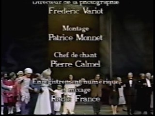

    Several minutes of both rolling and static credits. They don't "jump" as much here, but you can see that they stumble on themselves vertically. This kinda stuff just dares me to fix it anyway. Thank you for all this info.

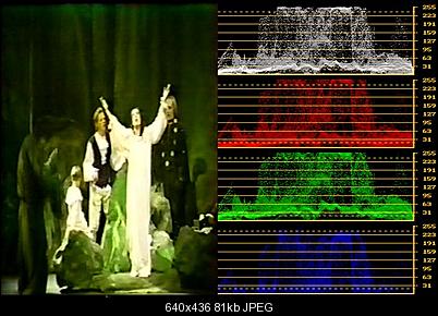

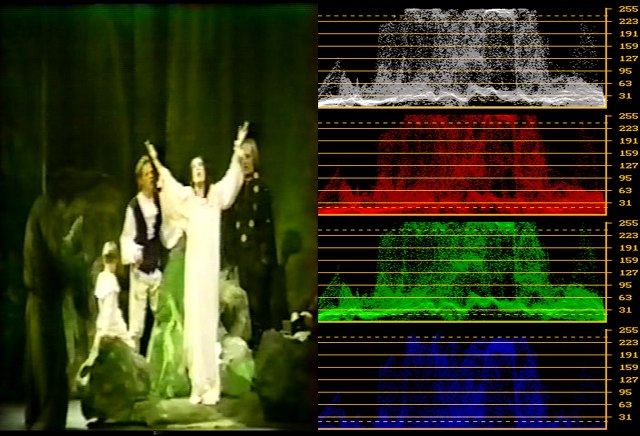

    Meanwhile . . . (A Bit Of) The Very Worst Of Act 3
    Wouldn't you know it. The worst crap on this capture, at the final Magic Moment. Mignon rises on the stage, the lights go down around the scene, and some big amber floodlights (heavenly light, I guess) go crazy center-stage. Then the whopper. 500 frames of doodoo. I don't even know why I bothered.
    Image of the last good frame before damage: The bright lights have just come up. The tape's owner managed to fry highlights and crush darks. I know it's supposed to be high contrast lighting, but this is murder. The 'scope from ColorTools shows colors climbing over (and under) the walls.

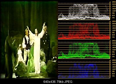

    Lower it in YUV, RGB, try to help the blacks. Doesn't matter. The highlights are g-o-n-e. Horrible, even for VHS.

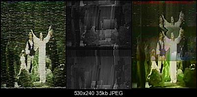

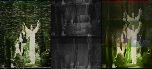

    Starting with the very next frame, somebody turns on the proverbial fan. 3 of the next 204 frames. Altogether it goes on for 500 frames.

  21. Banned
    New York, US
    I'll work on your idea, poiisondeathray. <sigh> Duty calls, I gotta repair a customer's PC tonight, will be working late. I'll be at the grindstone tomorrow.
    Looks as if I'll still be fixing this in the rest home.

  28. The section before the very bad section can be treated fairly well (409-486) with that method, but not every 2nd frame is bad, so you have to pick & choose and modify it a bit for the double bad frames, even replace the double bad frames with dupes or blends. I think you can still salvage them all.
    But the long section from (487-652) is composed of ALL bad frames, either completely wrecked or black/white. There is no good information to interpolate from .
    One way you might be able to treat that long bad section in AE is to rotoscope sections like a face, a hand, the dude moving in front, etc... - so you would take the last good frame, and the first good frame that are on the ends of the bad section as references , basically your goal is to go from point A to point B within that 165 bad frame span. Then you would animate the roto'ed objects maybe with something like the puppet pin tool. You don't need to do every frame, because there is keyframe interpolation
    One way you can complement this or speed it up is to generate "intermediate keyframes" using mvtools or related functions/filters . e.g. You would take that A, B point and generate a middle point using interpolation. Then do it again, and repeat. So what you are basically doing is generating middle points for each iteration, and "halving" the distance. The problem is the distance between the frames is so great that the interpolation won't be as good as if from a true neighboring frame. It's might be possible to tweak the settings for a "cleaner" interpolation - I haven't looked into it. I included a zip file that has the "A" point, the "B" point and the interpolated middle frame using default settings - you can see it's noticably blurrier and can see the edge morphing that I talked about earlier. Each interation after that will be even worse, because you are using that as new reference
  29. The "automatic" method might work ok... considering that sequence of frames are severely damaged in the first place, you don't really "lose" anything
    It's actually not as bad as I thought, because each interation doubles, so 2, 4, 8, 16, 32, 64, 128... So what I did was use Interleave() with BlankClip(), and each iteration, blankclip framecount doubles. Interleave alternates 2 clips, so the idea is to put a black frame between each "good" frame, so you can use mvtools to replace that black frame with interpolated frame. Since every 2nd frame is replaced, you can use the same excel trick and copy & paste, so it really only takes a few minutes. So starting from those 2 good "bookends", you generate 166 "in between" frames . I bet Gavino could write a super sexy iterative function that does this automatically, but the copy & paste method isn't too bad.
    256 is too many "in between" frames, but 128 is too few. So I used TDecimate(mode=2 , rate=167) to attempt to decimate semi-evenly spaced frames. So those will replace 487-652, or the "bad bad section". I suppose you can use mvtools again to generate more inbetween frames to get perfect cadence, but this should be ok for smoothness. In fact it's TOO smooth.
    So this sample clip represents 400-1291 . There are some interpolation errors, but IMO those artifacts are minor compared to the completely damaged frames. The main problem with that big long stretch, is it seems to be slower timing compared to the sections around. I don't know what the timing of the audio or the clip is, but every "bad frame" in that stretch was replaced. So maybe there were actually too many superfluous bad frames in that sequence. For example , maybe you only need 1/2 the frames for example, and fix the audio to match
