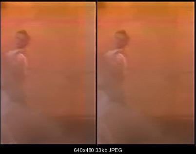

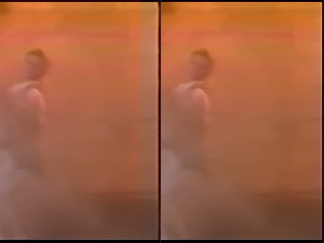

    A link to another version of the smoke-and-fire clip posted earlier (Wk50_TestB, original, FFT3D, and NeatVideo versions). After tweaking Tweak and ColorYUV, the bright border is less distinct. Each bsegment of this clip has different background colors, so a few more minor tweaks might kill this border altogether. Good thing there are only a handful of major background changes in this show. Clip is about 10-MB.
    http://dc221.4shared.com/download/1UUzlOC9/Wk50_TestB_Borders.mpg
    Below, the old right border is on the left, new work on the right.
    I was disappointed with the way Tweak "de-saturates" a color. Normally it's done by adding or subtracting white; Tweak does it by adding or subtracting unequal amounts of the other 2 colors, or just 1 color. Tsk, tsk. That doesn't desaturate, it just changes hue. They should know better. I tried playing with Tweaks "mask" parameters to get a grayscale involved, but AviSynth gives no clue how it works in Tweak.

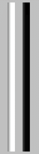

    The idea behind a partially-gradient mask arose from the need to feather overlay and mask edges -- e.g., a few pixels along one edge of the mask get gradually closer to white or black than the inner part. This, as I learned from another site lost in my Notepad files of thousands of found sites, is one method used by Photoshop designers to feather the edges of applied masks. I did figure out a way to do it in AviSynth, but it involved saving the filtered borders as separate files, saving parts as "strips" of varying density, etc., blah, balh........
    But wait! Thankee, poison, this had me ranting again, which led my ossified brain to an easier way .
    Now, all I need is time to do it.

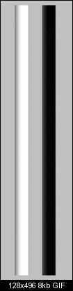

  24. Banned
    New York, US
    I managed to make gradient grayscale masks in Photoshop. The original photoshop BMP's are gradients that start out white on one side (RGB 255,255,255), while the last few edge pixels fade to a darker gray (128,128,128 or so, but I tried many different grays). Also made inverted (gray-toward-white) versions.
    Made the BMPs into 1-minute AVI's, 24x480 frame size -- same frame size as the "c" clip (right-border cropped from the original video) that gets filtered by ChubbyRain2 and then overlayed onto the main video. The mask's bright and dark areas affect how much of the original image shows thru after the filtered "c" clip is laid onto it (i.e., the mask will control the opacity of the overlay, from transparent to invisible).
    In the original VOB-to-AVI script posted earlier, there's lots of processing and border cleaning in YV12 before the source is converted to RGB32 AVI. After the reddish right border is cleaned by ChubbyRain2, its 24-pixel width (named "c") is overlaid onto the original clip (named "d") with this statement:
    overlay(d,c,x=328,opacity=0.8)
    After a mask clips was made, it was inserted into the script as follows:
    mask_c=AviSource("J:\Mignon02\Work02\MaskA\C1_Grad ientA_128_24pix.avi")
    mask_c.ConvertToYV12(interlaced=true).ColorYUV(lev els="TV->PC")
    The clip names don't matter here, as I tried several versions with different names and with variations of the load statements. Then the overlay statement was changed to this:
    overlay(d,c,x=328,mask=mask_c)
    Guess what? The effort made very little difference. Just using Tweak and ColorYUV workarounds alone, the filtered overlay is difficult to detect. You have to know it was there in the first place, and still you have to look for it.
    Anyway, at least I refreshed my AviSynth knowledge of overlay masks. And the masks did work in the test frames. Will be useful in other ways. Here are images of two of the 24x480 gradient masks I made (one is just an inversion of the other). Each has a "feathered" edge:

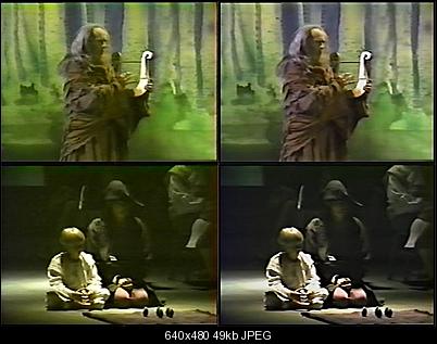

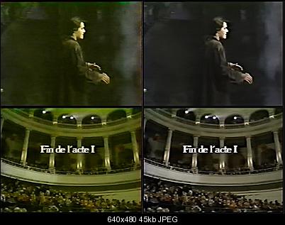

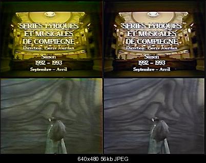

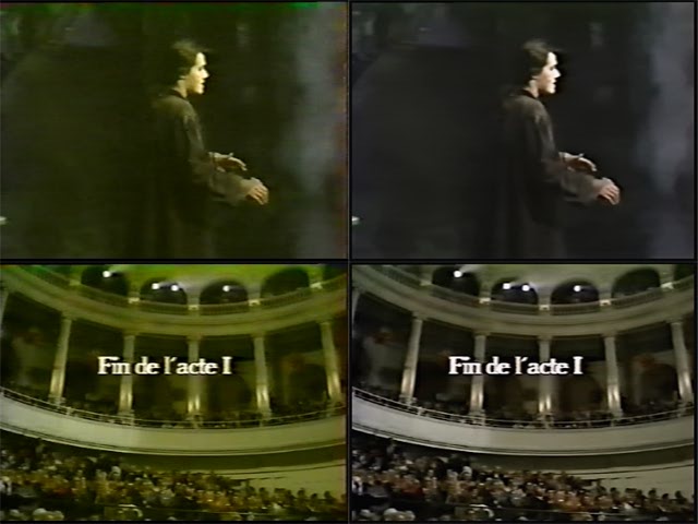

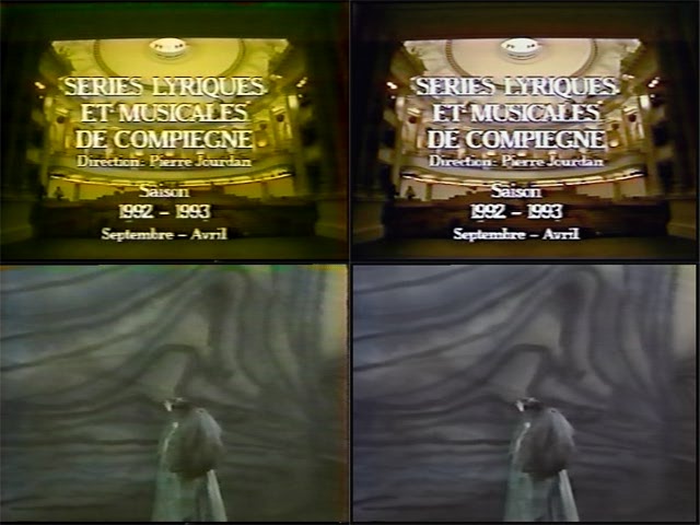

  30. Banned
    New York, US
    Finally got thru Act One. Made up a quickie (?) 1-1/4 minute before-and-after demo of selected horrible moments from the original. Audio is MPG-Layer2; the DVD will be AC3. NOTE: In the "after" version I made a fooh-pah and used an early clip from which I deleted 2 noisy frames instead of just one. You'll see a movement "jerk" there, but it's undetectable in the final DVD.
    All my monitors are calibrated, so if you use out-of-box settings on your monitor or TV I have no idea what you'll see. If you use uncalibrated monitors for video work, you're beating yourself up anyway (out of the box, a monitor or TV has brights 300% too high, oversaturated red, terrible low-end gamma, etc).
    "Before" demo (32-MB):
    http://dc239.4shared.com/download/PY6qtYoF/VOB15_demo_original.mpg
    "After" demo (50-MB):
    http://dc239.4shared.com/download/4VnvY2_M/VOB15_demo_after.mpg
    Here are half-size pics from the demos. "Before" on the left, "After" on the right:
    On to Act Two! And thanks very much to everyone who contributed to this thread.
