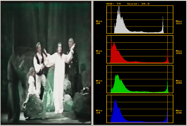

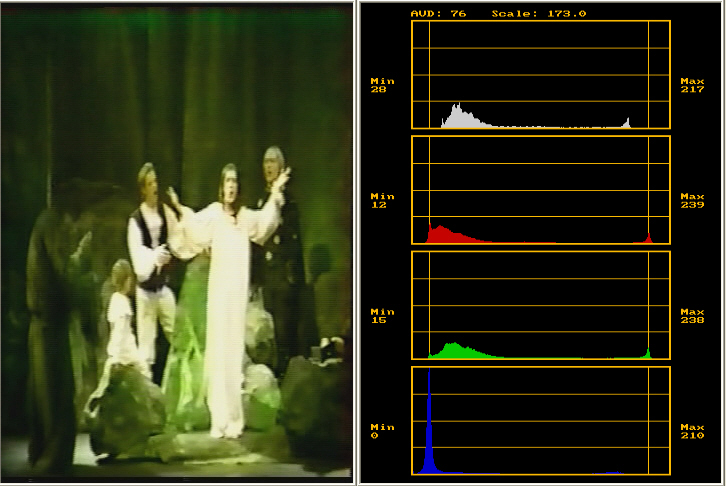

  3. Originally Posted by sanlyn View Post
    Folks, I'm back to my early contentions about these colors. First, we, know that Blue gets gradually squished to the left. By show's end, Blue is decimated. YV12 isn't connecting Blue with luma correctly anyway. Histograms and pixel readers show Blue values changing numerically, but YUV or RGB filters can't move Blue much above the equivalent of RGB 128 or so. Try it yourself. A color filter tells you bright Blue numbers are changing, but the image shows little or no action above the high midtones.
    Back to working with ColorYUV, etc., for now. It's improving. But it still reeks.
    Dumb question, but are you applying the filters before color tools ?
    Also isn't this supposed to be on the darker side (lowly lit performance) , so isn't most of the data supposed to be in the shadows? The stage lighting will register as a small peak on the high end, and I think that's all the bright data there is supposed to be ?
    Now are you talking about the distribution in the blue channel (the "shape" in the histogram) ? The amplitude of the blue channel is high (a large peak) but occurs at low values of the histogram (seems like the whole channel is squished to a peak and shifted left as you said earlier). So most of the blue data is distributed in the dark shadows (and half of it is clipped if rec601 is used). The color tools in vdub shows the whole histogram, so you see the entire top of the peak, and the rest of the data appears diminished - this skews the visual representation of the other channels (you can see scale factor at the top).
    Did you try swapping out the "bad" blue channel ? The scale (if you use vdub color tools) will appear to be more balanced, because the amplitude of the blue peak and the distribution will be in line to those of the other channels. In the example below, if you use the color picker you will notice that the dress and clothes are closer to white now (assuming that's what they were supposed to be - and if it's not - maybe there was colored stage lighting - you can add you own color cast with other filters if you know what the stage lighting was supposed to be) . Moreover, this is almost automatic (you don't have to change scene-by-scene or keyframe changes) , because it swaps the RGB blue channel from luminace values of the corresponding YUV clip . Now it still looks green, just a different shade of pukey green - but the point was to "fix" the blue channel before you start with your final color corrections.
    Curves (there's one called "gradation curves" in vdub) is the most powerful tool IMO. Non linear and almost infinite control. You are not just limited to 3 way shadows, midtones, and highlights. You have a lot more control in redistributing data in each channel than say, levels which only allows for linear control.

  4. Banned
    New York, US
    No filters, just run ChubbyRain2, tweak with ColorYUV, then to RGB32 AVI. We are getting similar histograms, but I'm not having to move Blue as much as you seem to be. I think the lighting in this show is warmish anyway at the high end (theater lights usually run around 5500K, unless gelled). The cap you posted of the ending scene is too cyan. But I think those folks are under amber gels; the color balance has more high blue after the curtain closes and the lights come up for applause.
    To answer the next question in your post: the last 1/3 of the show is fairly somber. It's preceded by a violent fire scene at night (!!).
    Later I'll use my usual filters: gradation curves, RGB-EQ, ColorMill. I found a little trick with ColorYUV. Tried a contrast tweak (cont_u=-25 to -50) -- it pushes blue out a little. Going below -50 didn't help much. "Cont" spreads from the middle outward. Now near the point where really heavy post-filtering isn't needed, just tweaking humps and trailing ends. With poor mapping, the colors won't get that clean, so flesh tones are really trying.
    Swapping channels gave worse results, even tho I spent most of today with it. The blue peak around RGB 64 and the sharp upper-end slope is due to poor mapping (and protection effects? ?), but swapping seemed to replace problems with new ones. Best to concentrate on one color; working with two is tough, three is impossible. ColorYUV is getting close, with fiddling. It's more helpful in later scenes. I have a pretty good handle on Red and Green; the only thing I'll likely have to struggle with is Blue, about once every half-hour of video. It seems to be mapped to some really high luma at the low end (i.e, oversaturated, even at low numeric values. Remember, there's "hue" and then there's "brightness"), and low luma at the high end. I still think that's deliberate; the other colors aren't acting that way.
    The trick at the end is to compare the curtain call scene with the earlier one, and you'll see they use tricky lighting that throws you off. Get lots of blue in the death scene, then the curtain opens and everything's blue as hell. Also check fades to black, fade to white, white titles on black screens, etc. If they look clean, the rest should fall into place. That fade to white is a blessing. You don't see many of those!
    Gotta go repair a PC now. Will try to get some reasonably short YV12 clips direct from the VOB and post them on 4shared for those who want to torture themselves. Believe me, the first 1/3 of this video will look easy.

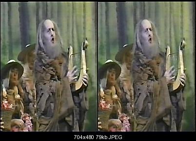

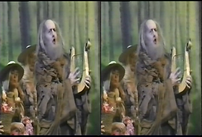

  18. Banned
    New York, US
    Poison, AviSynth on many an occasion has one big advantage over NV or VirtualDub, for which there's no substitute: working in YV12 and YUY2.
    Game time! Below are caps of frame 13591. <- "A" at left, "B" at right ->. One is from the original after going thru ChubbyRain and into AVI/RGB32, but before NV. The other was run today with NeatVideo. Which is the original, A or B? This is the scene with bad motion flicker in the trees from "Opera_C", but these caps are from today and the new color work Poison and I, et al, are driving ourselves nuts with. This is some of the worst "detail" I've seen in VHS in a spell, but whaddya gonna do?
    Clues. Look at how soft-edge areas blend into areas of a different color. VHS and low bitrates usually have noisy stuff there. Try the gray beard and the edges blending into skin tones: any noise in that blend? How are shadows defined on the left of his face, are they losing shape, blocking up? More clues: soft blobs of darker green on tree trunks, dark blobs and subtler blends; do they disappear, or is some of that more subtle stuff just "noise"? Even better: look at the two women, lower left (Ah, Mais oui!). They're in lower-density light, not the best for digital video. NV is a decent hand at removing compression artifacts ("wiggles") around edges. Look at the front girl's face and ts edges blending darker or similar colors; which has more distinct edges and transitions? There's some squiggles between the outer edges of her hat an the figure beside her and scenery behind. top of her into the darker shadows under the hat -- Which pic has more noise there? Which appears to have less definition in the softer clothing on the figure behind her?

  19. Banned
    New York, US
    [I've never used it myself (and have no intention to do so), but I've seen plenty of videos that have come out of Neat Video, and they've all been effectively ruined by all the detail being wiped out.
    Since you've never used it, don't understand how it works or doesn;t work, never diagnosed its misuses, don't know anything about it, don't know how others use or misuse it, don't know that pros have used it for years but don't know how they got better results, don't know and don't wanna know, and ..... wait, repeat that??
    The original unfiltered versions and early NeatVideo versions of 3 videos were posted earlier. They're free downloads, no wait. Take a look. We're working with a really crummy transfer and looking for your ideas. Some have offered theirs and we've learned much and used some of it. I used AviSynth for 7 years and was disappointed, but I still have a ton of their plugins, have been trying them again for several days, used Poisondeathray's and others' excellent AviSynth suggestions and tips, and I'll try more. I'm not averse to stuff that works.
    Download OperaC_original.mpg. It's never been processed, it's straight off a VOB. Show us how to stop the ugly flashing on camera pans, we'll try it. I used NV and it cleaned it up. I don't see any detail loss (what little detail there is, which ain't much). fft3D couldn't even see noise and 3D convolution just made the old man's nose disappear. Tell me how I've erred. and show us your experiments.
    Just behind this post is another one with two images posted. So we're having a little contest (well, we have to play sometime!). One of those images is from unprocessed AVI, the other is the same frame after NeatVideo finished removing the flashing noise. It should be easy for you to tell mus which image is one that's ruined.

  22. sanlyn
    Side-by-side is hard to see the differences between A and B. Photoshop layers shows better and we can see real improvement NV could do.
    I'm not sure if is the point, but maybe we could try to apply some FFT3DFillter, DFTTest and MCTemporalDenoise to compare too. All that tools are valid when they bring and show good job.
    Thank you.

  29. I could try some scripts and settings our master sanlyn sent to me and the result is here:
    http://www.4shared.com/file/rRsAuLLp/stackH_huff.html (it is only a 9.5 Mb file)
    I have to admit that I am very happy with this. Not only with still frame, but mainly in movement we can see a very nice improvement of the video quality. It was well worth the effort and we do have a real better look, even with the poor quality of the source.
    Ed.: Keeping all the fine details, destroying nothing!
    Thank you sanlyn. Very good job!
