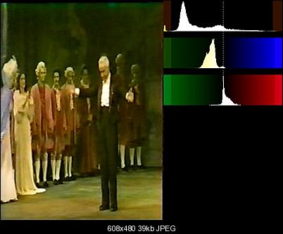

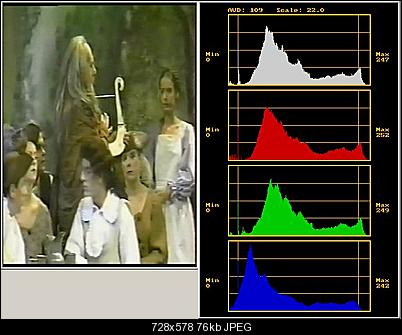

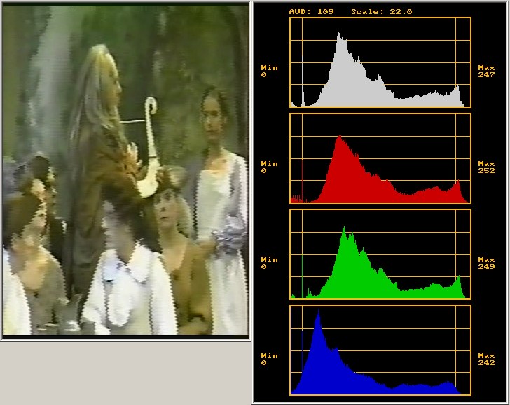

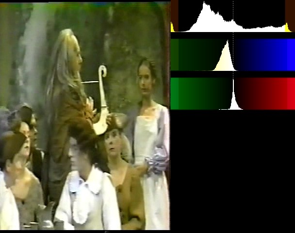

    Just burned up half a day looking into the color problem. And I mean, problem! Histogram below is the clue. Think you can just move Red/Green to left a bit, then move move Blue to the right and stretch it a little? Dream on. Low-blue color is lost, period. But worse...I just figured out that this was a PAL VHS recorded to an NTSC DVD. Simple? Not with home gear and (likely) cheap PAl->NTSC adapters.
    PAL is EBU color standard, but SD-DVD/VCD is SMPTE color. Similar, but not alike. PAL chroma/luma don't transfer as you'd expect. You lose chroma and luma info, and you get shot in the head at RGB below 15 and above 235. Yes, I already did the AviSynth "matrix" route, etc., etc., and lots of other stuff. The histogram (and vectorscopes, etc.) all show the same problem.

    The image was captured running original YV12 video with AviSynth.

  7. I see what you mean, the blue channel is clipped . Usually when something is clipped, it's not recoverable - even before RGB conversion
    But even shifting the blue channel (increase blue gamma) to make the histogram look more balanced still makes it look bad
    I edited my post above - you can play with correction in different colorspaces with gradation curves in vdub

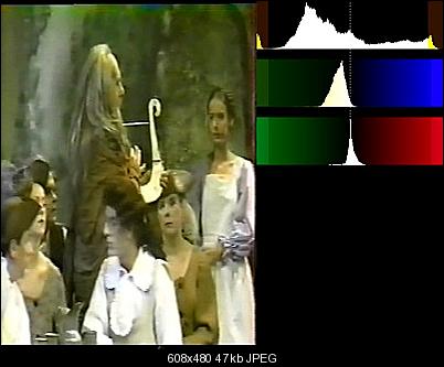

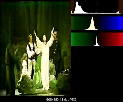

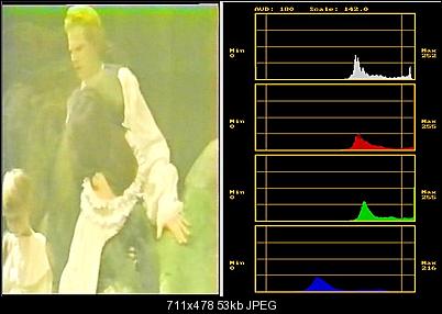

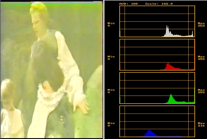

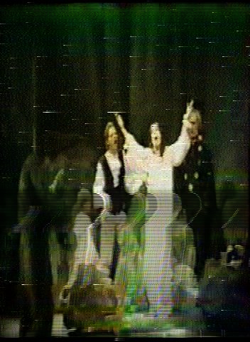

    You ain't seen nothin' yet. Gets worse. I assembled 1-min 47-sec from the vid's suitably climactic mid-Victorian finish. By that time the noise level is evil, highlights are fried, blue nearly gone, etc. I cut most of the applause and then dissolved to the last curtain call, and cut some rolling credits and some lead-out. At the end you see the tape stop and then Aiwa's logo; the right-side red stain ends and histograms look normal. But the top border stripe turns pink and persists, with many pink rainbows (from the player? the recorder? Cheap copy adapter? Crummy composite wire?)
    The "Fin.mpg" I made has AC3 audio. Maybe it's me, but in AVI/PCM the sound creeps gradually to the right, but in AC3 I get 2-channel mono. Must check that later.
    9.6 seconds into this clip (frame 288) there's a harsh blip from damage that doesn't fade for 400 frames (11 seconds). It briefly breaks copy protection timing and you get a mere 3-frame blink of what the color might be like. I added a startup fade-in and ending fade-out in AviSynth, and a dissolve about midway (NOTE: The climactic dissolve-to-white is in the original! Not my idea).
    This link http://www.4shared.com/video/BTebgpzS/Fin.html goes to that tiny yoo-toob type player where you watch a mini version or download the real one. The mini player blows up full screen but it's really really really blurry and actually hides the problems.
    This link http://dc192.4shared.com/download/BTebgpzS/Fin.mpg goes directly to the file. A left-click loads it into your MPEG player (takes about 5-min, though). Right-click, then tell the popup menu to save it. 61-MB.
    One of many speed bumps. This one's in the worst of all moments, right at the Big Finish. Histograms thru the opera show brights crushed even worse than darks. The tape's owner really loved that fast-rewind-and-replay feature.
    Climactic dissolve to white (uh, I mean yellow). Blue really suppressed here. What's stops one from bumping Blue forward? It's shaped like Green and Red, but nudge it ahead and it shrinks to a skinny triangle.

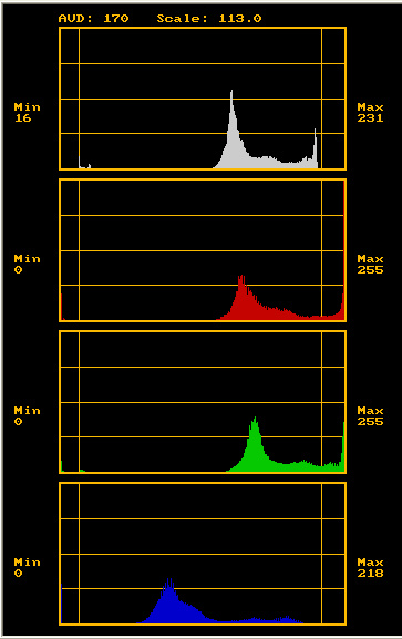

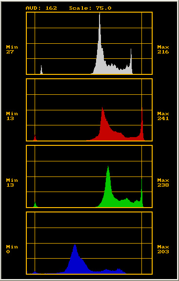

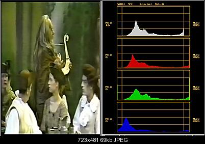

  14. Originally Posted by sanlyn View Post
    How can you have RGB lines placed as they are and still have a histogram read "MIN 0" for all 3 colors? Of course the ColorTools histogram and vectorscope are programmed to display only 0-255 numbers. By the time the video goes YV12->RGB, the original luma/chroma is converted to something else, and too late to transform the info.
    It's because you converted YUV=>RGB using rec601 matrix, or let vdub do the conversion (if you use full processsing mode or any vdub filters). So any data less than Y<16 , Y>235 is lost . Y [16,235] is mapped to RGB [0,235] . If you specify the RGB conversion in avisynth to use PC.601 , Y [0,255] will be mapped to RGB [0,255] . This is critical when recovering shadow detail, highlights (maybe not in this example, but in general). But it's important to remember convert back to YV12 with appropriate matrix as well. This was frame 1000 in the "fin.mpg" sample, about the same frame as your last screenshot
Name:	avs rec601.jpg
Name:	avs pc601.jpg
    poisondeathray, thanks for bringing that up. I'll check it out and get back.
    When working "for real" I never let VirtualDub make colorspace conversions. The fin.mpg cuts were processed entirely in original YV12 and AviSynth. It saw VirtualDub only to get its histogram, but VDub was looking at AviSynth working in YV12. But now that you mention it, I think I'll go back to that YV12 work file and use AviSynth's histogram. Thanks for the tip, that would be a good way to double-check things. I always thought VDub's RGB default was PC.601 (why would a PC-only graphics application default to "TV" instead of "PC"?). When I took pixel readings from VirtualDub to make the earlier videos, I was seeing 0>255 pixel values for all colors. But that changes by the end of the opera.
    Thanks again for checking my work, poisondeathray. In a major respect, you were right ! Originally I did it correctly. Step 1 was to make a 10-minute master AVI converted to RGB32 for NeatVideo. I made that AVI correctly with a PC.601 matrix. Step 2 was NeatVideo. But with Step 3 and later I was copying old scripts I used a while back for a VHS job that used VirtualDub only for display, never for processing. So the old scripts always used the default matrix. For the current project, when I copied those old scripts and updated them, I neglected to update the matrix parameters.
    Shucks. Oh, well, last night I decided to start again with Step 3 anyway, so I have only two later scripts to revise. Starting after NeatVideo with Step 3, I pooped-up the matrix.
    Matrix problems aside, the Blue/Green displacement from SECAM->NTSC remains. Phooey.

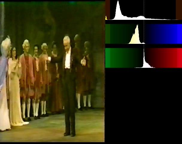

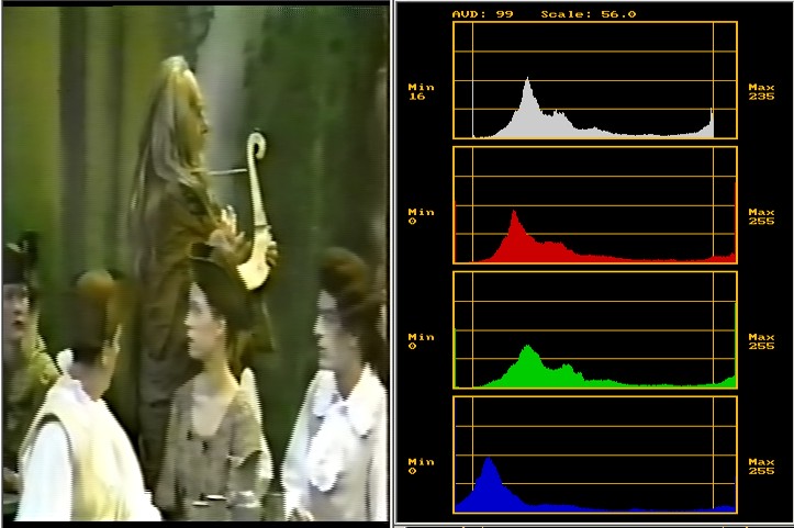

    New caps. This time, I'm just reading the original YV12 VOB's in AviSynth. No processing. Here's frame 10454 in YV12 with AviSynth's own YUV histogram. You can see the middle U channel shifted left, with the bottom V channel where it should be. This frame was chosen as one having varied objects and a wide color scale of darks, midtones, brights, whites, flesh tones, etc.

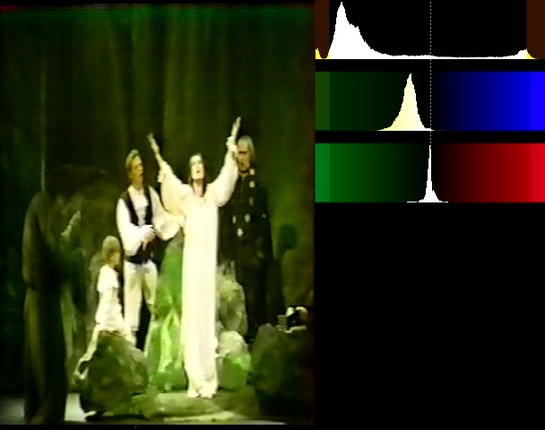

    The cap below is the same frame in RGB32 (PC.601, RGB 0-255). ColorTools shows the slow, early slope in Red and Green, making the video look washed out. Blue is displaced left and slopes too late, getting clipped at the low end. On tyhe right side, Blue peaks too early and slows too early, at least for this broad-spectrum scene.
    You can play with RGB or YUV filters all you want, in any color space. The colors will never line up properly, and if you try it you'll severely clip either the brights or darks on at least two colors or often all three.
    Another problem: the "brightness" or intensity of a color (hue) as you see it is partly related to its RGB value, but also to its Y-luma. The YDbDr spectrum doesn't scale color brightness the same way PAL and NTSC do. If you take pixel readings off this frame you'll see that blue goes all the way out to high RGB numb ers, yet the overall color balance often looks as if Blue is lacking in spots, even where it peaks at the dark end. This is not the forum to get into CIE color spaces, represented as triangles, but a color's position in that triangle has much to do with how we perceive it as "off" or "on" the right color. You see this especially in reds on this video, which tend toward orange or scarlet, but are never really a clean "Red".

  23. Originally Posted by sanlyn View Post
    That's a good selection for a test frames, the girl with skin tones without the (white/grey/blue ?) pastey makeup on . I don't have that exact frame, but similar one from "operaC_original.mpg"
    It looks washed out because Y=0 is mapped to RGB 0,0,0 and Y=255 is mapped to RGB 255,255,255 - so there is a contrast stretch compared to using truncated values if you are setup to decode and display as rec601. If you didn't all that data at the ends would be gone. That's about 13-14% of the data gone (assuming you had a source with data in that range). It's a similar idea to using a wider gamut colorspace to do your color corrections in photos, so you don't clip the data. When you export and convert back to YUV data using the PC matrix it will look fine (RGB 0,0,0 will be mapped to Y=16), when that YUV data is decoded for display with a rec601 matrix (YUV data has to be converted back to RGB again for display , and the way you have it setup will vary. Most hardware devices, DVD players will use rec601 for YV12=>RGB). I think there is a way to set it so you see it as if you were converting back to YV12, or you might have to fiddle with the vdub display or graphics card settings (well at least there is in other programs, not sure about vdub)
    You can use the channel swap , or coloryuv in YUV space to line up the channels in the histograms.
    You can reduce the clipping by working in full range (and doing the full range RGB<=>YUV conversions instead of truncated) for the intermediate color correction.
    Screenshots 1 & 2 demonstrate this. This was done in AE, frame 100, "operaC_original.mpg". 1) shows importing with rec601 conversion 2) shows importing with full range. As mentioned earlier, there isn't a lot of superdark Y<16 data, just some blips, but other cases are much more dramatic (especially when you are trying to recover blowouts and shadow detail). Notice the I set it so the preview displays the same (ie. no contrast stretch despite different YUV<=>RGB conversions) , because when I export with the proper matrix, that's how it will look. There might be a way to set it up in vdub as well.
    1) Rec601
    2) Full Range
    Screenshot 3 shows the channel swap (with blue channel "fixed") , plus some minor curves adjustments afterwards, to demonstrate you can roughly line up the histogram. I purposefully crushed the low green values , because even with the channel swap, there was still a nasty green color cast. You can do similar shift with mergeRGB in avisynth
    3) AE Channel Shift + curves
    Screenshots 4 & 5 show it using coloryuv in avisynth , using off_u for the U channel. (just to demonstrate that you can shift it ; you still have to do color corrections, it's just a new starting point like the RGB blue channel swap).
    4) Avisynth YUV histogram
    5) Avisynth YUV histogram with coloryuv(off_u=-11)
    I didn't bother with the border-color-fix in these examples, they are just to demonstrate fixing blue channel data or U channel data in RGB or YUV colorspace, as a starting point for color correcting (you would also do the color border fix in YUV space first)
    Another bad sign: AviSynth's info() command says this video is "608x480" pixels, not 640x480 (and not 352x480). If you stretch a frame to 640x480, people look a little fat or squat to me. Oh, well...that's for later.
    I don't have this problem. It works fine for me. What source filter did you use ? Can you post your script ?

    Good show, poisondeathray, thanks for the caps. I don't have AE, but in VirtualDub/AviSynth we both did pretty much the same thing. My original Opera_C, though, does have my Rec601 error in the final output. Haven't had time to rerun the later steps.
    One can stretch and shift and get fairly close to decent colors, until you're an hour into the show. By then you notice Blue has been shrinking into the left-hand corner and audio is shifting right. Even without those oddities, color and brightness change several times, sometimes abruptly, as if someone fiddled with image controls during playback. By the end of the show Blue is severely suppressed; you don't need a histogram, it's obvious when you play the original DVD to a TV.
    What we're doing with filters is trying to reconcile two different YUV colorspaces, YDbDr and YCbCr. Remember, our filters are designed to work with RGB and YCbCr, even if YCbCr really is what the Phillips recorded. The U/V formulas I posted earlier are similar to using colorYUV etc. to shift channels. But that simple formula doesn't quite work. One still fiddles for hours, and it changes every few minutes. I've also learned that YDbDr and YCbCr don't scale colors the same way, i.e., there are nonlinear gamma alterations and other minutiae I've been reading about. So there's no simple Add-2-here, subtract-4-there transform.
    The methods poisondeathray shows are like those I used, and this just might be as close as we get to a fix. The CIE color gamut is still off (some of that is also due to VHS playback and NTSC hue problems themselves, plus cheap connecting cable, etc., as I've often seen).
    If anyone wants to burrow really deeper (or has a/v engineering background) I found some C++ for converting colorspaces, including YDbDr. The "colorspace.m" function posted at this site (http://www.math.ucla.edu/~getreuer/colorspace.html) is for still images. I'm more interested in the general YUV principles, but have trouble translating C++ I haven't used since 1998 - and no way I'm digging up my old Visual Studio 6 and spending days installing, much less weeks learning stuff I never used anyway. The attached .zip has the html page and a subfolder with C++ code as an ".m" file (open it in Notepad). It's the same package you get from the site's download link.

    An unfiltered cap from 2hrs 48-min, near the end of the tape. This is YV12 from the VOB with AviSYnth's YUV histogram. You can see that Blue has shifted farther left.
    A few minutes later, with different colors. This is during curtain calls, so lighting should be more uniform, with more colors. If the previous scene might have been lighted a little warmly, this scene should have a more "neutral" range. It looks as if Red has shifted right. But that could be the red costumes. The guy's white shirt is red-yellow. His tux and shows are green, with red-brown schmutz. Red costumes: either they're red-orange, or the CIE scaling is really screwy. For all we know, they could really be pink.
    The Blue shift is gradual, so I suspect it could be copy protection effects. If not, then it's heat damage. The question would then be, why is Blue damaged less at the start and more at the end? Having ruined a few tapes myself, here's my forensic guess:
    The red stripe at the right side of this video is kinda uniform throughout the tape. This suggests the tape was stored upright, with one side near a source of direct heat. Either that, or the tape was stored one-side-down near a heat source. Either way, this would affect one edge of the tape more than the entire layer. Further, let's say the tape had been played to the end and then stored upright or face-down near a heat source, with the tape wound onto the right-hand takeup reel instead of the left-hand feed reel. This means that the end-of-show would be wound as the outer layers, and the start-of-show would be the inner layers. Thus the outer layers (ending) would have more exposure to heat.
    Anyway, poisondeathray's excellent ChubbyRain2 did a good job cleaning that border.

    In some frames, there is uneveness - parts of the frames are colored differently. For example in test.mpg, in the beginning sequence, the background curtain is both blue and green - how can this be?
    Oops. Missed this one, poison. The thingie with the big wave isn't a curtain. It's a scrim. Like lightweight canvas. When lighted from the front it appears opaque, though not 100%. When the scene behind it lights up, it looks transparent. Reduce the light in front and power up the lights in back, and you see mostly the scene behind it. It works like a "dissolve" in film. At some point the scrim was raised as the scene progressed, but raising the scrim seems to have been edited from the video. Sometimes when the lights behind are not up, you do see light reflected from objects behind it. We're probably seeing some reflection off all that green scenery behind the scrim.
    See, I knew my M.A. in Theater Arts would be useful sooner or later .
