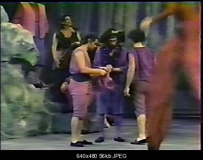

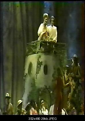

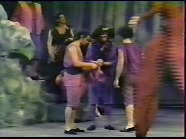

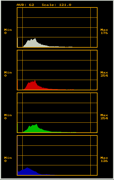

    Just had a closer look at these samples. Is it possible for you to post a frame or two from your original master (i.e, before you made any conversions or other processing). You should be able to get a frame capture or two from VirtuaDub. Use any picture viewer to save the capture off the Windows clipboard as uncompressed .bmp -- don't save it as JPG, as most programs make very low-quality JPG's. The video's format is 352x480, so one or two BMP's should not be very large files.

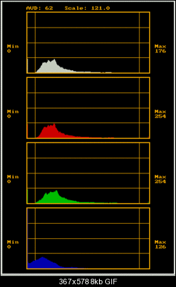

    The AVI's have severe color space conversion problems. Have you noticed there's no blue, and that shadows are yellow and/or green? Color correction isn't possible with color space errors. Add all the blue you want to the AVI frames, it will never look correct.

    man, you are great! Looking deeply in my samples by an expert is all I'd love to have.
    I put more than one or two BMP samples, captured from original VOBs:
    http://www.4shared.com/file/Dog6BF9X/samples.html
    If you could find the best setting for NeatVideo, or other VD filter, I think I could say my working on Mignon was over (and I admit, a little bit of nightmare would gone...)

    Those colors are pretty bad - is that the way it looks when you play the tape and watch on your TV,
    or is that something from the capture process ?
  6. davexnet
    I am not sure how it looks on TV. My source is only one DVD, an old one. In fact I explored it and found files I didn't know about:

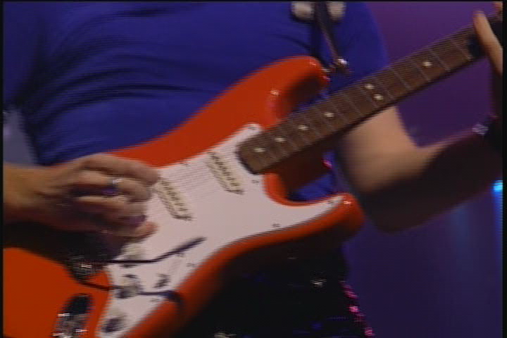

  15. @Lord Smurf - It's definitely reproducable , even on an interlaced workflow.
    It's more noticeable on anime, but I have some live action sequences where its painfully obvious. You don't even have to pixel peep or zoom in to see something funky is going on. I'll upload a sample clip later
    Even if it occurs some of the time (in my opinion it occurs all of the time) , that's enough IMO to spend the extra minute with avisynth.
    EDIT: OK a non anime example: top is vdub, bottom is vdubmod, and a sample clip appended below for your own testing. It's easier to see whenever you have red on black or (red on blue) . Make sure you view at full size

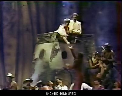

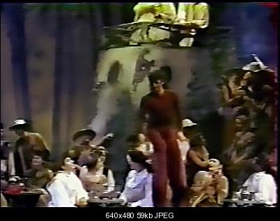

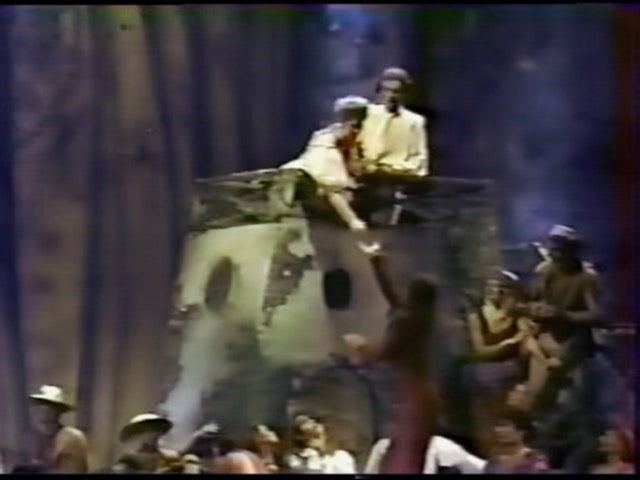

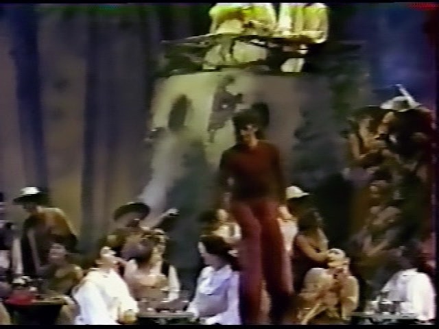

    3 caps from VirtualDub. Original saved as Photoshop images (uncompressed), with no modfication. Converted to JPG 95% quality with Photoshop plugin HVSJPEG-2.
    The video was converted to AVI uncompresssed (RGB24). (1) via DGindex/AviSynth. (2) via VirtualDub 9.1.4/FccHandler's MPEG2 plugin. (3)VirtualDubMPEG2 1.6/MPEG2plugin.
    I'll be using the DGindex/Avisynth version. They look alike to me. Would still like to know why the Vdub conversion is so inconsistent. Last time I saw a problem was maybe 2 years back. It's been a while since I used MPEG source; I always capture VHS via VirtualDub straight to AVI/RGB24/huffyuv (Never had a problem that way, but there was no MPEG->AVI conversion involved). Will keep looking at the other versions later.

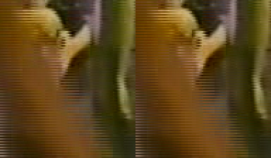

  22. It might not be as clear as in that example I posted above, but the errors are there. It's more clear with motion, and more clear with red on black (or red on blue)
    Here is frame #225 by vdub numbering
    You can see the highlighted boxes where vdub vs. vdubmod (or avisynth dgindex) handle the interlaced chroma differently. Notice the line spacing on the color bands on top.
    The "zoom" was a nearest neighbor resize with mod16 crop on exported png. All captures were done with "copy output frame" Ctrl+2 and pasted into image editor and saved as png.
    Imagesource()
    Crop(144,208,-112,-160,true)
    PointResize(last.width*2,last.height*2)
    If you notice in the "zoom" picture, the lines have different color
    Anyways this is getting off topic... Let's see what things can be suggested to improve this source

  23. Banned
    New York, US
    It's subtle, poisondeathray, but I see it. Still, all caps show badly serrated edges, no matter how the conversions are made.
    You can see from the images above that test.mpg has interlace and color space problems. As with the avi samples earlier, Blue is depressed. However, adding Blue didn't make the overall balance look correct. Below is a Color Tools histogram. All frames in test.mpg give the exact histogram, with depressed Blue. The fault of stage lighting, maybe (tends to be warmer), but yellow shadows in white objects don't look good.
    I don't know how the original CVD was made. Originally recorded from a stage production onto VHS? (It doesn't look like a retail VHS). Played back on a VCR with bad heads? Recorded with a low-quality capture device? Recorded directly to a Philips DVD recorder? A cut from an original VOB might look different (wombie having hiccups? Who knows). Maybe we can get a direct piece of a VOB straight thru DGIndex/avi synth to D2v? This won't be easy.
  24. Instead of adding blue, another approach might be to removing green (e.g. one way might be to use RGB curves and lower the the green channel curve). At least with curves you can do non linear changes (e.g. just shadows , or affect highlights less)
    But the bmp screenshots posted present other bigger problems. The colors, hue, and levels issues are not consistent between scenes. So I suspect whatever treatment will have to be done differently on different sections. Also the method in which screenshots were taken is important - was the conversion done with RGB full range? Was it Rec601 16-235? etc... Assuming it was consistently done, it still leaves the same issues
    I agree this will take a lot of work.
    I don't do much of this type of stuff, so I'm trying to learn from you guys as well.

  26. Banned
    New York, US
    Instead of adding blue, another approach might be to removing green (e.g. one way might be to use RGB curves and lower the the green channel curve). At least with curves you can do non linear changes (e.g. just shadows , or affect highlights less).
    Actually, there's too much green. The whole video is green, period. I'm mainly using VirtualDub's gradation curve filter, similar to Photoshop's (also using Photoshop to examine frames).
    Not only do they change from scene to scene, they change within scenes. Look at test.mpg as the camera pans, and you'll see at least 4 major changes in color balance and lighting (I hate those old AGC controls on VCR's). This appears to be a recording opf a stage production, so expect uneven lighting and artsy effects as people move around the stage.
    Some work in full-range RGB (PC), some use TV. I think full-range gives a better idea of how video displays on a modern tv. When you see colors jammed up against the left edge of a histogram, you know the color's crushed on PCs and TVs alike. As for 601/709: on a pro monitor ($5000 and up, not counting $25,000 worth of associated gear) you'd have to use that setup, but consumer PC's use RGB. In effect, all 3 standards look very much alike. My monitors are calibrated with Gretag-MacBeth/EyeOne Display2, which lets me set my PC display close to what you'd see on tv. Most PC monitors out of the box are 300x too bright, grossly over-saturated, and have weird gamma curves that look like the Santa Anita interchange.
    After all that, you watch the results on TV and you still find more corrections. It never ends.
    We're all learning from each other. That's why it's so much F U N

    test.mpg caps:
    Here are two caps from test.mpg, encoded with TMPGenc (352x480, 4000 VBR bitrate, 5000 max). I think you'll be able to see the effects of making master recordings from VHS at low bitrates and small sizes. Color and image density are a mess, but at least it's not totally green. Blue is crushed in the original, meaning that shadows are always gonna be warmish (red) because blue detail below RGB-40 or so just ain't there. Also note corruption along the right edge. Likely this came from the tape, along with the stripes across the top. No fix for this.
    The more people you see, the less you can make out. Highlights are wiped out, as you can see from the white shirts (even tho I set filters to cut contrast above RGB175 or so; the details were wiped out long ago. Note: to the right of the red center figure and behind him, there's a dense brownish shadow. This blob changes shape occasionally as the camera moves, but it's totally crushed: nothing there to retrieve. Meanwhile our fair damsel at the top has gone easter-egg green. You can't make the imager righter; highlights are already toasted and there's very little shadow detail to work on.
    I wouldn't use the Wombie method for processing. Interlace and color problems are severe, even worse than plain VirtualDub conversions.
  29. Banned
    New York, US

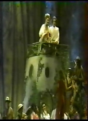

    Here's a cap from the D2v you posted (thank you). reported the file was not a D2v project file, so I used the m2v instead. This is from the MPEG2 encoded with TMPGenc. AviSynmth/DGIndex Pretty noisy chunk of video, but VDub's built-in temporal smoother set at 5 removed almost all of it, NeatVideo with very low settings killed the rest. The DGIndex cut is more workable, but let's face it -- the small capture size and low bitrate don't give you much to work with. But it still looks somewhat better than the test.mpg video.The original VHS must surely have been of higher quality than the CVD.
    I corrected some color, though the scene doesn't clue you as to what it should look like. I assumed the guys' leggings (stockings ? Whatever.) should be a light, generic flesh tone. The shoes and the pirate hat are black, so is the cloth covering the gal in the background. Once I got black for these objects, most colors fell into place. There's no real RGB-000 black in here: again, dark Blue was crushed, i.e., dark blue detail is nonexistent. This is a soft image that's actually too soft to sharpen. I set NeatVideo's sharpener down to 20%; setting it higher gave an etched-glass look that made horrible motion noise on an LCD every time something moved. Getting the colors smooth is impossible: look at the lady standing in red at the upper left. Colors are smeared and tainted with chroma bleed and low-bitrate artifacts.

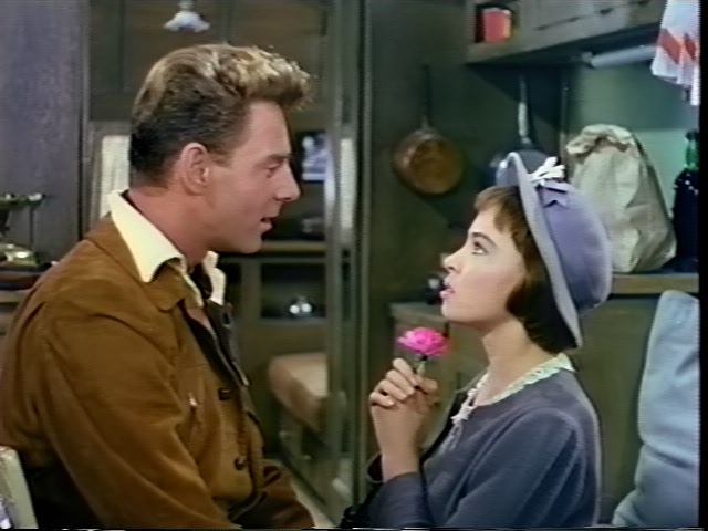

    I'm posting below an example of a workable VHS capture from the movie "Lili", a very old and slightly damaged VHS I've worked on occasionally for 2 years. This scene has been thru NeatVideo, but it needs a ton of color and other work. I post it to show the difference between a direct-to-AVI capture -vs- other ways of copying a tape. Let's face it, VHS has problems as-is without adding detrimental methods to the process.
    Panasonic PV-8661 VCR via composite, then Toshiba RD-K2 DVD recorder used as pass-thru line-level TBC and s-video converter, then ATI AIW 9600XT AGP capture card via VirtualDub to huffyuv AVI.
