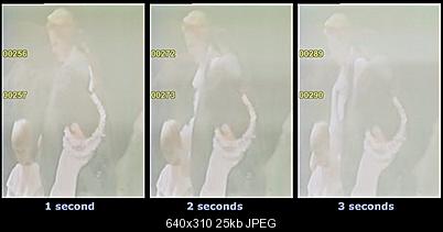

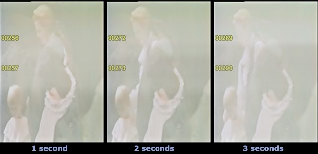

    I wanted to see what the TMPGenc Editor v.3 crossfade feature does with video/audio sync. While working on the Big Finish sequence I broke the scene into 3 pieces (before, during, and after the white dissolve). I made 3 pieces because each required color balance/contrast fixes -- due to sloppy mastering work on this tape, it has many dissolves with badly mismatched color/contrast in joined scenes. After joining the 3 parts with crossfades, I noticed the results had a slightly different number of frames than I started with.
    For a test I made two versions of a clip showing frame numbers. Each version has the same 509 frames (0 to 508). Clip "A" displays frame numbers in the left-middle; clip "B" placed frame numbers slightly higher, so I could tell which frames from which clip might be outta sync.
    When I made crossfades with AviSynth's Dissolve(), I had to play around a bit with one or two start or end frames to maintain audio synch -- because I was joining pieces of a continuous scene with music and lip movements, rather than joining different scenes with different content.
    TEMPGenc Editor has crossfade settings in 1-sec increments. I made tests for 1, 2, 3 secs, with crossfades starting at frame 240. I started crossfades at frame 240 because, after rendering to MPEG, frame 240 was key frame #0 in a GOP of 16 frames (0 to 15) in both clips. A dissolve would begin on key frames for each clip. Clip A was rendered to MPEG in TMPGenc 2.5 with frames 0 to 240 + 120 more frames for crossfades. Clip B was rendered to MPEG starting at frame 240 to the end (so Clip B's first frame was also a key frame). Thus, in TMPGenc Editor the only clip that had to have trailing frames cut off after frame 240-plus was Clip A. Clip B always began its crossfade on the same frame 240, so there was no need to cut frames from Clip B.
    One would think that for crossfades starting at frame 240, Clip A would be 240 + 30 frames per second. But frame speed is actually 29.97 fps, so full frames don't compute to exactly 1, 2, or 3 secs over 30, 60, or 90 frames. I was curious to see how TMPGenc Editor handled this. Frame 240 is 8.01 secs into the clip. I made these images at about mid-dissolve point.
    Test 1 (Clip A is 1 frame ahead of Clip B)
    1-sec: Clip A = 240 + 30 frames (9.01 secs)
    2-sec: Clip A = 240 + 60 frames (10.01 secs)
    3-sec: Clip A = 240 + 90 frames (11.01 secs)

    1-sec: Clip A = 240 + 29 frames (8.98 secs)
    2-sec: Clip A = 240 + 59 frames (9.98 secs)
    3-sec: Clip A = 240 + 89 frames (10.98 secs)

    Makes sense to me. An MPEG editor can't work with two-tenths of a frame, so it looks as if TMPGEnc chose to work with the nearest full-frame only. For those who really need to know. . .

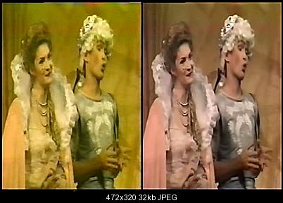

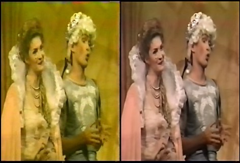

    Yet another godawful problem in this godawful video that can't be solved right now. I refer to the green overlay (and its buddy, a red rainbow) that runs along the top quarter of cassette #2. In some scenes I've managed to subdue it. But it's of a nature that no filter will see it as noise; it looks like just another ugly thingie on the tape. It'll take some trickly masking and overlays to fix. And time.
    The two pics below are: (Left) From the original source DVD, untouched and in all its, uh, glory. (Right) After first run with AviSynth/Tweak/ColorYUV, chubbyrain2/cnr2 (2 passes), NeatVideo.
    The scene is too red, and too faded and soft for much more fiddling. In the right-hand pic you can see over the guy's head an orange remnant of one of the flashing spots or bubbles that streak the across the top several times in many scenes. MVTools helped clean some frames, but couldn't fix them all. In the 7-second clip below, most of the sparkles are about mid-clip.
    NTSC MPEG2 Layer-2, 7 secs. 4-GB
    http://dc416.4shared.com/download/lFs4JMKD/N1_W05B_B01Kx_pops.mpg
    When taming the red and trying to get some color depth into this image, the Bad Greenie along the top becomes prominent (as usual). Below, in the left-hand shot you see it as a different hue along the top. As red is subdued and a little saturation is applied, Greenie comes alive in middle and right images.
