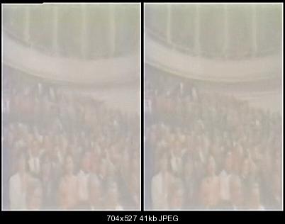

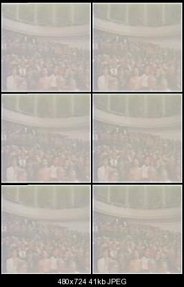

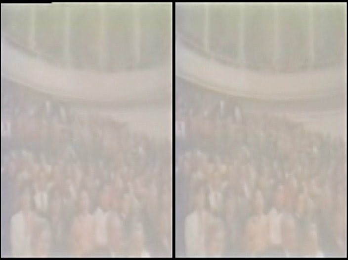

  28. Banned
    New York, US
    Every time the camera pans across or down in this awful video, no two fields in any frame look alike. Motion differs in each frame (and each field). Finding a "bad" field surrounded by "good" ones is almost impossible; there will be several bad guys in a row. Often a glitch in the top field of frame 1 will appear as the same glitch in the bottom field of frame 2 or 3. Even/Odd fields often don't appear to be in sync. The attached 1.4-second AVI shows what I mean. This is at the opera's end, when the all-white screen dissolves into a panning shot of the audience.
    huffyuv AVI, 1.4 secs (41 frames) 6.6 MB. Frame 8 in this clip corresponds to frame 680 in the MPEG's posted above. The clip shows that the dissolve from white suddenly gets darker than the previous frames.
    http://dc268.4shared.com/download/FKVRZCsc/L_Frames_674_714.avi
    Here's a pic of frames 12, 13, and 14 of the attached clip, using separatefields(). Even (top) fields on the left, odd (bottom) fields on the right. Note the way the white horizontal balcony near the top changes shape irregularly.
    Top Fields (left): in the middle image, compared to the top image, the shape of the balcony has changed: in the middle image the top middle curve bows downword and the bottom of the curve has dropped down a few pixels -- but the left-hand edge stays where it was. The balcony's overall shape is slimmer and bows downward in the middle. In the bottom image, the entire balcony has expanded at both the top and underside, so the balcony is now "fatter" than in the previous two fields. It's not the same shape as the right-hand balcony.
    Bottom Fields (right): in the top-right image, the balcony is "fatter" than the balcony on the left. In the middle-right image, the midsection of the balcony's curve has dropped a bit, but the bottom of the curve stays about the same shape. In the bottom-right image, the balcony's left and right corners drop, but the rest of the curve hardly moves.
    The left and right balcony shapes and pillar positions seldom look alike between fields. The shadows underneath the balcony also change shape in every frame. See Even/Odd fields in frame 14 below:
    I was able to smooth some of this with mvtools. I even tried AssumeBFF instead of TFF! There just aren't enough well-behaved fields to do what I wanted.

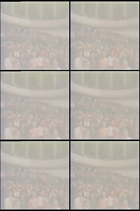

  29. I suggested this for the "morphing" problem earlier - you can treat that with QTGMC and TTempSmooth. You can also treat the aliased edges on the balcony this way (the jaggy edges on the bottom left of the balcony)
    Unlike that other clip, this ending section has barely any detail to preserve to begin with, so you probably don't even have to use masks. Fine details like hair, face detail, smoke etc.. tend to get erroded - so be careful when using it. Also be careful about using them on "non clean" sections, as the temporal filtering will propogate the errors. As usual, adjust the settings for your taste
    MPEG2Source()
    QTGMC(preset="slower" , edimode="eedi2", sharpness=0.3)
    TTempSmooth(maxr=1, lthresh=24, cthresh=4, strength=4)
    And to re-interlace it for TFF for going back to mpeg2/DVD
    AssumeTFF().SeparateFields().SelectEvery(4, 0, 3).Weave()
    Here is the comparison of AssumeTFF().Bob() on the left, before re-interlacing. Trim(1200,0) was used for this comparison (so frame 0 corresponds to frame 1200). You may have to open it up in vdub or avspmod and go frame by frame to really appreciate the differences
