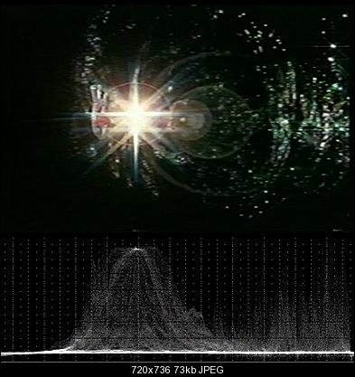

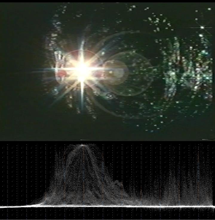

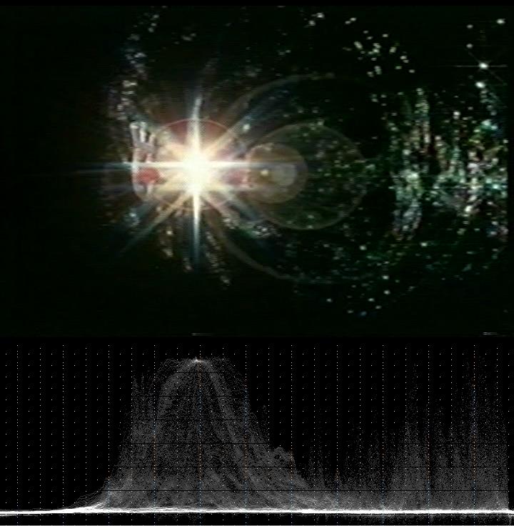

    And this is about what it should have looked like:
    There's also something very suspicious about that file. There are 8 lines of black (very near Y=0) at the top and bottom of the frame. At the bottom the VHS head switching noise is above that black bar. I think this means your capture card, its driver, or the software you are using is mishandling the video -- downsizing it improperly and adding the black borders. Can you capture with VirtualDub?
