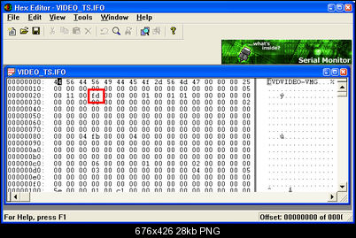

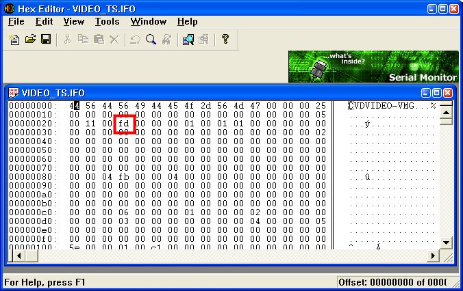

  5. I believe this will work: rip the DVD as a VIDEO_TS folder with DVD Fab with the region free option disabled. Use a hex editor to change the 35th byte of the VIDEO_TS.IFO file from FD (region 2) to FE (region 1). Burn a DVD.
    If you find a 00 or FF there the disc is region free. Change it to FE to make it region 1.
    Again, you are still likely to have a PAL/NTSC problem. This guy claims to have worked out a "simple" but crude way to convert PAL to NTSC:
    https://forum.videohelp.com/threads/278458-DVD-Rebuilder-No-PAL-to-NTSC-option-Why?p=19...=1#post1990981
    Maybe you can write to him for details.
