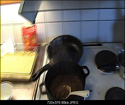

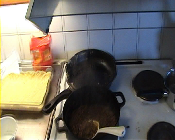

I could really use an helping hand. If anyone else here has worked with this DV camera (or similar models in the same family) it would be awsome. My camera captures at 720x576. Anyways, when capping raw DV .avi clips, I notice how the far left edge gets some sort of yellow shimmer.
Is this normal??? Or have I somehow damaged my camera? Some people say that PAL D1 is actually 704x576 active pixels, i.e. the far out 16 pixels is therefor not to be trusted.
