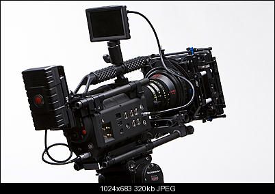

    L5.1 appears to use four to five times the bandwidth of L4.1 and looks to be for very high definition video, 4096×2304@25 or similar. You might take a look at this article as it seems to have a lot of information on the different levels: http://rob.opendot.cl/index.php/useful-stuff/h264-profiles-and-levels/ L5.1 would probably give better quality, but you would need a source video at that quality and a program or device capable of playback. Maybe this type of source:
