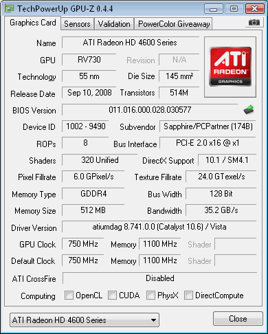

    The Card is PCI-E, I had stopped looking at the issue for a while but I was looking around last night and I noticed something odd, the the CCC it listed the Maximum Bus Bandwidth as 2.0 1x ... it should be 2.0 16x, so I'm currently trying to straighten that out, maybe its just that card stinks.

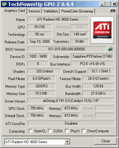

    GPUZ should give info. mines like this

    Wipe isn't an option at this point, took me a few weeks to get everything on there and this system is the DVR so it's constantly in use. I did verify with GPUZ lastnight and it said the same thing but actually that is PCI-E 1x 1.1 I'm wondering if the card is not insertered physically I'll check that when I get home. Most everything matches except bandwidth and bios probably because of the Difference in memory type.

    Nov 2006
    Done and Done, once I got it back to x16 DXVA display came back with it. I was trying this guide for anyone that's effected http://forums.techarp.com/reviews-articles/23881-how-fix-pci-express-x1-bug-10.html
    However it didn't solve my issues, what I ended up doing was moving the card to the second slot, which got it to x16, I moved it back to the first and along with moving some power cables and SATA cables I was back at x16 there too. No idea if the power and SATA cables were causing interference or if its just a weird issue with my board.
