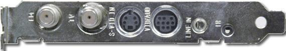

  10. Originally Posted by hech54 View Post
    The 350 originally came with an adapter that plugged into the "thing" next to the S-video input.
    You mean the 9-pin connector?
    I thought that was only for output.
    Found the pinouts (in German):
    http://www.vdr-wiki.de/wiki/index.php/Pinout_PVR350
    Google translation into English:
    http://translate.google.com/translate?js=y&prev=_t&hl=en&ie=UTF-8&layout=1&eotf=1&u=ht...50&sl=de&tl=en
    Indeed, pin 8 is composite video input. So the OP just needs to be sure he gets the right adapter.

  12. Member SHS's Avatar
    Oct 2000
    Vinita, Oklahoma
    [Attachment 2490 - Click to enlarge]
    That rigth the 9 pin is Video Output

    Given that I can find the right combo of card/connector, as I see it there will probably be a deterioration in quality using (converted) composite input...even if the software can find this input on a connection designated as output. If I can live without TV-out and Radio tuner then with an actual on-board composite input, the PVR250 would be the better choice? Are there any other differences between both models (250 and 350)?

  14. I believe the PVR-250 and PVR-350 use exactly the same chips. The 350 simply adds the ability to output video. The 250 has both s-video and RCA composite connectors on the back plate since it doesn't need room for the video output connector.

    I'm not sure the RCA connection via the optional daughterboard would be considered deteriorated quality. Sure it's taking up another slot on the PC but the connection method and connection itself(to the 350) looks to be very good quality.
