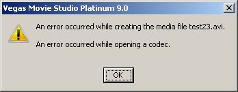

    Hi, I trying to create Xvid from Vegas but I have problem with the sound.
    I can pick Xvid in video but when I going to pick MP3 in Audio it have nothing that I can pick
    I did then find information that I have to use Lame ACM to make MP3
    Now I can pick MP3 in audio but when I going to start rendering it say something is wrong with the codec.
    Right now I have to first create a very very big AVI that have no compression and after that open VirtualDub to create Xvid.
    But I like to make it a little easy so I can create Xvid from Vegas instant.
    What do I have to install to make it work?

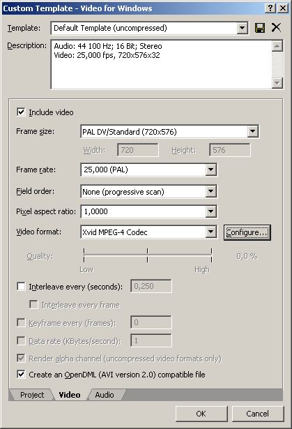

    well I don't know what more I can do then this
    Image Attached Images
  4. I don't use Vegas but it looks like everything is set up correctly. Hopefully someone who knows Vegas will chime in. It will help if you say which version of Windows you are running, and whether it's 32 bit or 64 bit.
