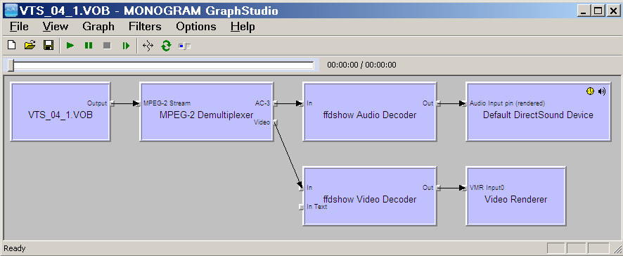

    You should think of containers (.AVI, .MKV, .MP4, .VOB, etc.) as boxes that hold audio, video, and other stuff with a particular organization. The audio and video inside those boxes can be compressed (or not) with any of a number of codecs (some containers are more flexible than others in this regard). The process of playing a video consists of opening the box, separating the stuff that's inside into separate "streams", sending the audio and video streams to codecs to be decompressed, and finally, sending the decompressed audio and video streams to the sound card and graphics card. A media player can perform these steps itself, or it can ask Windows to do any or all of them for it.
    All that is done by building a "filter graph". Here is a simple filter graph shown as a flow chart:

    Windows (DirectShow) looks through the system installed filters to see which filters can perform each of these steps. A computer typically has dozens, even hundreds of filters installed (in GSpot, select System -> List Codecs And Other Filters to see a list of installed filters on your system). There are often several filters that can perform the same jobs. A complex negotiation takes place between DirectShow and the installed filters to determine which filter is used and how data is passed from the output of one filter to the input of the next.
    The graph above shows data flowing from left to right. First is a File Reader, a filter that tells Windows this is indeed an A/V file and it knows how to handle it. Next is a File Splitter that separates the compressed audio and video streams (sometimes the File Reader and File Splitter are combined into one filter). Those compressed streams are then sent to appropriate decompressors (ffdshow in this case). Finally, the decompressed streams are sent to renderers that play the audio and display the video.
    The good thing about this system is it makes it very easy to extend DirectShow for new file types (containers), codecs, and other filters. If you invent a new container or codec you can simply write the appropriate filters. Anyone who installs those filters can now use DirectShow to play your files. The bad thing is it's easy to corrupt the system with a malfunctioning filter. For example, you often find that two programs install filters that do the same jobs but are not compatible with each other.
