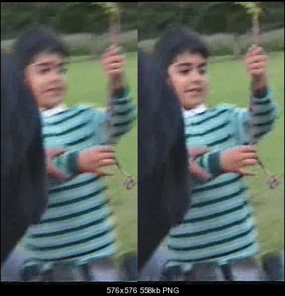

    VirtualDub's deinterace (Yadif mode) worked fine with that video (although it was way over compressed with Xvid). Before, after:
    There are better deinterlacers in AviSynth but it may take you a while to learn AviSynth.

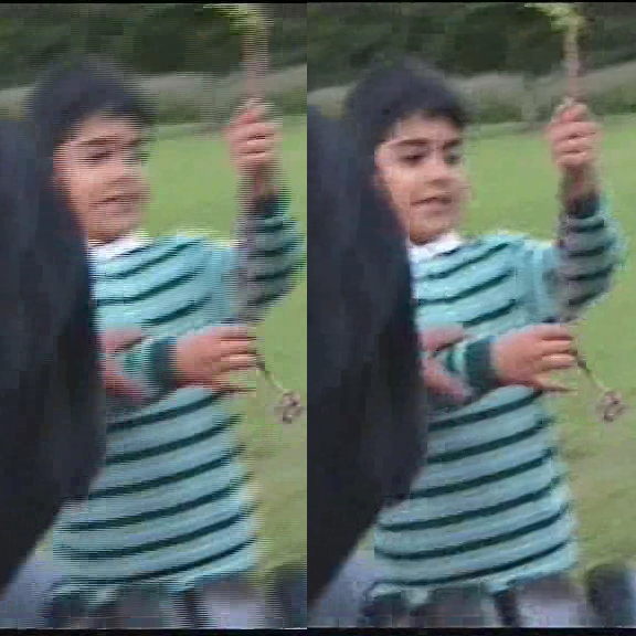

    Here's a few seconds of your video with Xvid deblocking and deringing, and TempGaussMC (double frame rate):
    AVISource("testclip2.avi")
    AssumeTFF()
    TempGaussMC_Beta1mod()
    If you want 25 fps instead of 50 fps add SelectEven() or SelectOdd() to the end of the script.
