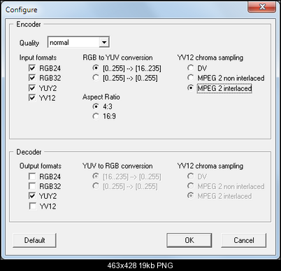

    Bumping up an old thread hear instead of starting a new one. I want to give Cedocida a whirl. I am capturing VHS which is played through a Toshiba W-808 S-VHS which then passes through a Panasonic DMR-ES10 (S-Video + Stereo Audio) and then into a Diamond TVW750USB into a computer running Windows XP x32. Using VirtualDub to do the capture
    I am uncertain how I should configure Cedocida based on my equipment. Could someone help me out?
  12. Set your capture card to capture as YUY2. Cedocida should be set like this:
    Change the aspect ratio settings as appropriate for your source. If you capture YV12 set the YV12 chroma sample to MPEG 2 interlaced. Other Output formats can be used but I prefer to leave it at YUY2 unless I have a need for the others (like an editor that requires RGB).

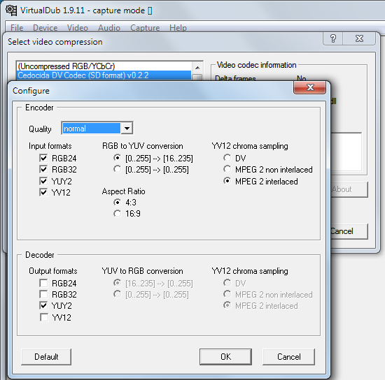

    Jan 2010
    I'm a little confused on using Cedocida while I capture. When I go into Capture AVI in VirtualDub, Cedocida doesn'ts how up under Compression options for Video. All I have is uncompressed. Is thre a way to have this captuer and compress to DV as it captures?
  14. Cedocida shows up in VirtualDub on my computers.
    Jan 2010
    I don't need to copy anything into a virtualdub folder do I? I see Cedocida under Video/Compression (while not in capture mode), seems unusual

    Jan 2010
    Upon further investigation, when i choose the capture device as AVStream Analog Capture (DirectShow), which is how the Diamond device is showing up, I can't select Cedocida. Likewise, if I select Microsoft WDM image Capture Win32 (VFW) it doesn't show up. This device doesn't let me capture with the card either. if I select emulation, Cedocida shows up.
    So it appears the codec is not compatible with my capture device?
  18. If HuffYUV shows up Cedocida should too.
  19. I have HuffYUV installed and it works in capture mode yet Cedocida is not showing up in capture mode for me in virtualdub either....
    Jan 2010
    I tried it on another computer, I think it has something to do with the capture hardware not allowing it. I'm just going to end up passing through my DV camera.
