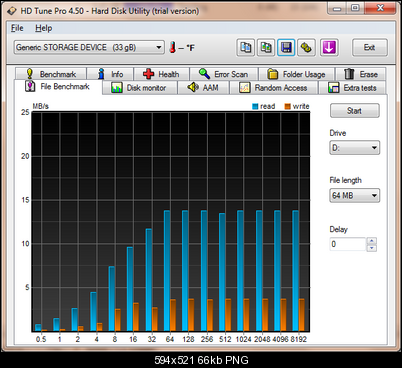

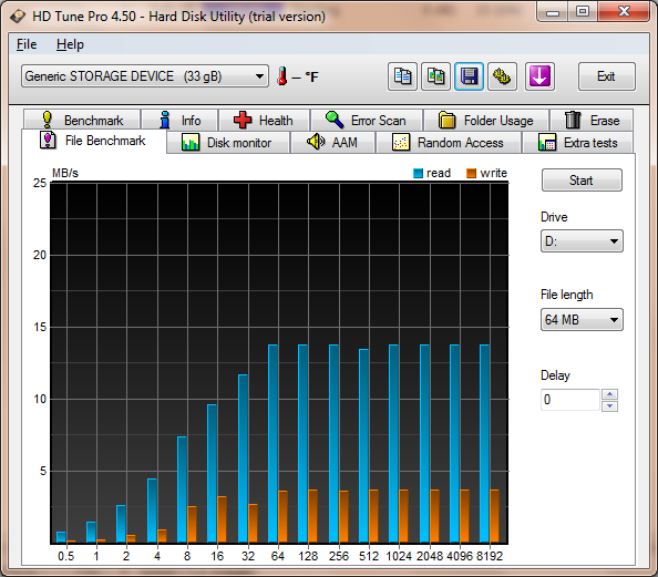

    A "new" card doesn't ensure that it's corrupt. Is it SD card? Try some benchmarking software like HDTune, CrystalDiskMark or other related software

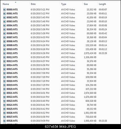

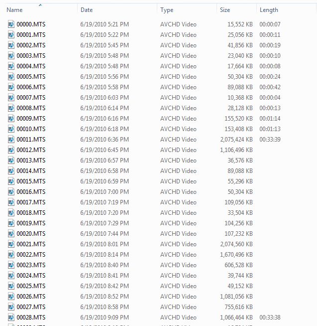

  5. I've copied the files over to my hard drive. Is that what you are talking about concerning recovering files? Attached is files from my testing and a partial list of what the files look like in Windows Explorer.

  6. They look corrupt, even on windows explorer, there is not reported duration
    What's interesting is 12-27 look corrupt, but 28 (and on I presume) report a duration - are those ok? I wonder why it would fail only in the middle recording section ?

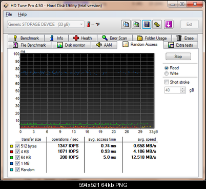

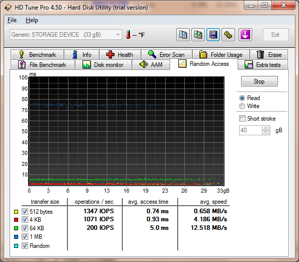

    You can check error scan or some of the other tabs in hdtune , it may give some other information (might not work on sd cards)

  7. I did the error scan but there were no errors.

  8. You attached read tests, but those are rarely a problem. You should look at some write tests. Can I ask what brand of card?
    EDIT: sorry I didn't see that attached text file, there are some write tests there
    The sequential writes should be enough to satistisfy your requirements. You are only recording <24Mbit/s (which is ~3MB/s). You actually record less than 24Mbit/s (that's the max spec for AVCHD) , I think your model only does 17-21? not sure. Eitherway it shouldn't be a problem. Note 8Mbit =~ 1MB
