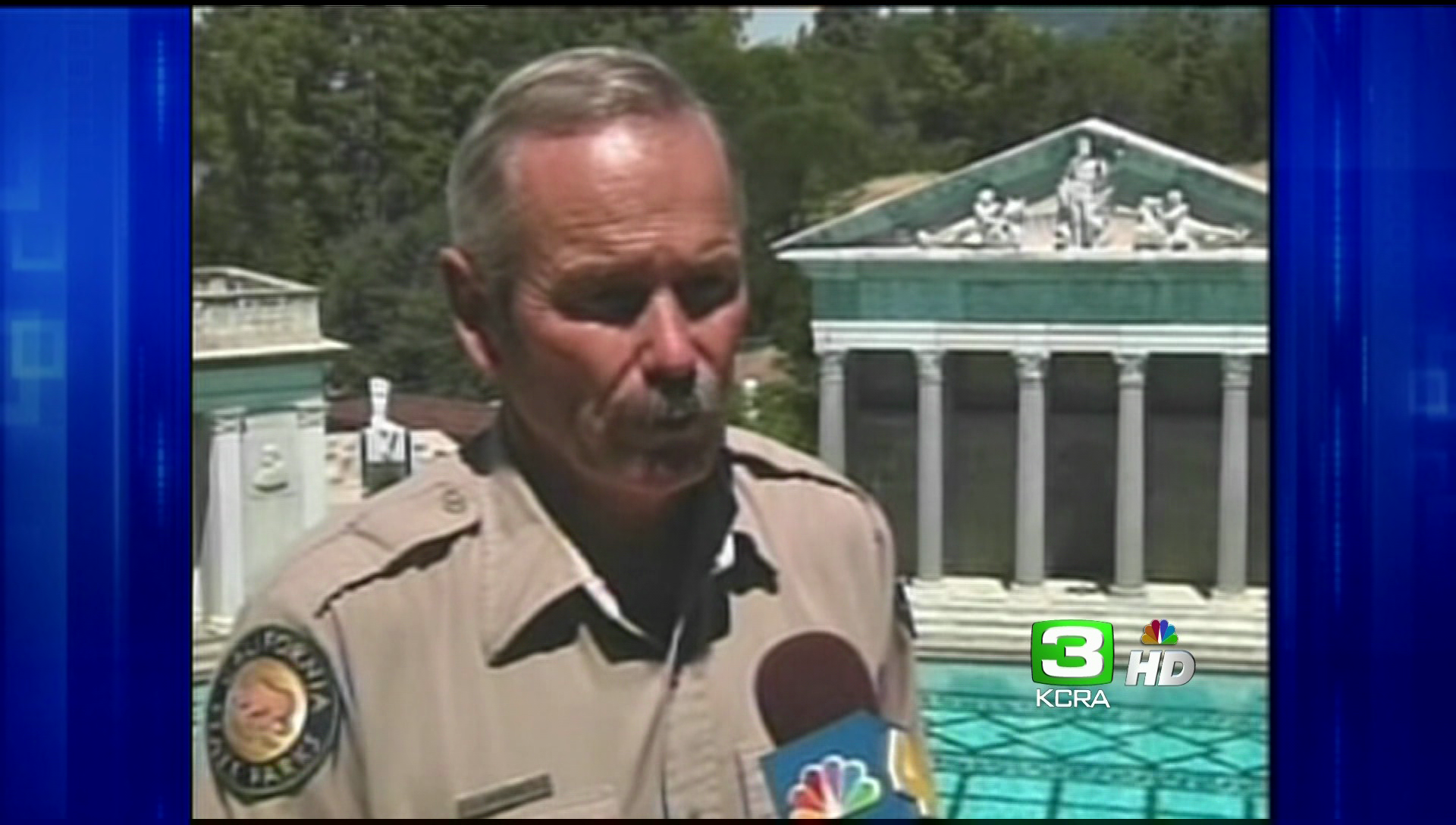

    Out here in CA we get a mix of 16:9 and 4:3 news clips. In this case a KNBC-4 LA story on neglected maintenace at Hearst Castle State Park. This is true on all network and local news broadcasts. These guys are cash strapped to equip every news crew with 16:9 HD cameras and edit bays.

    @eddv - thats what we get sometimes here to. A lot do broadcast live in 16:9 but not all the time. Also much of the imported clips from other networks/world feeds look like that.
