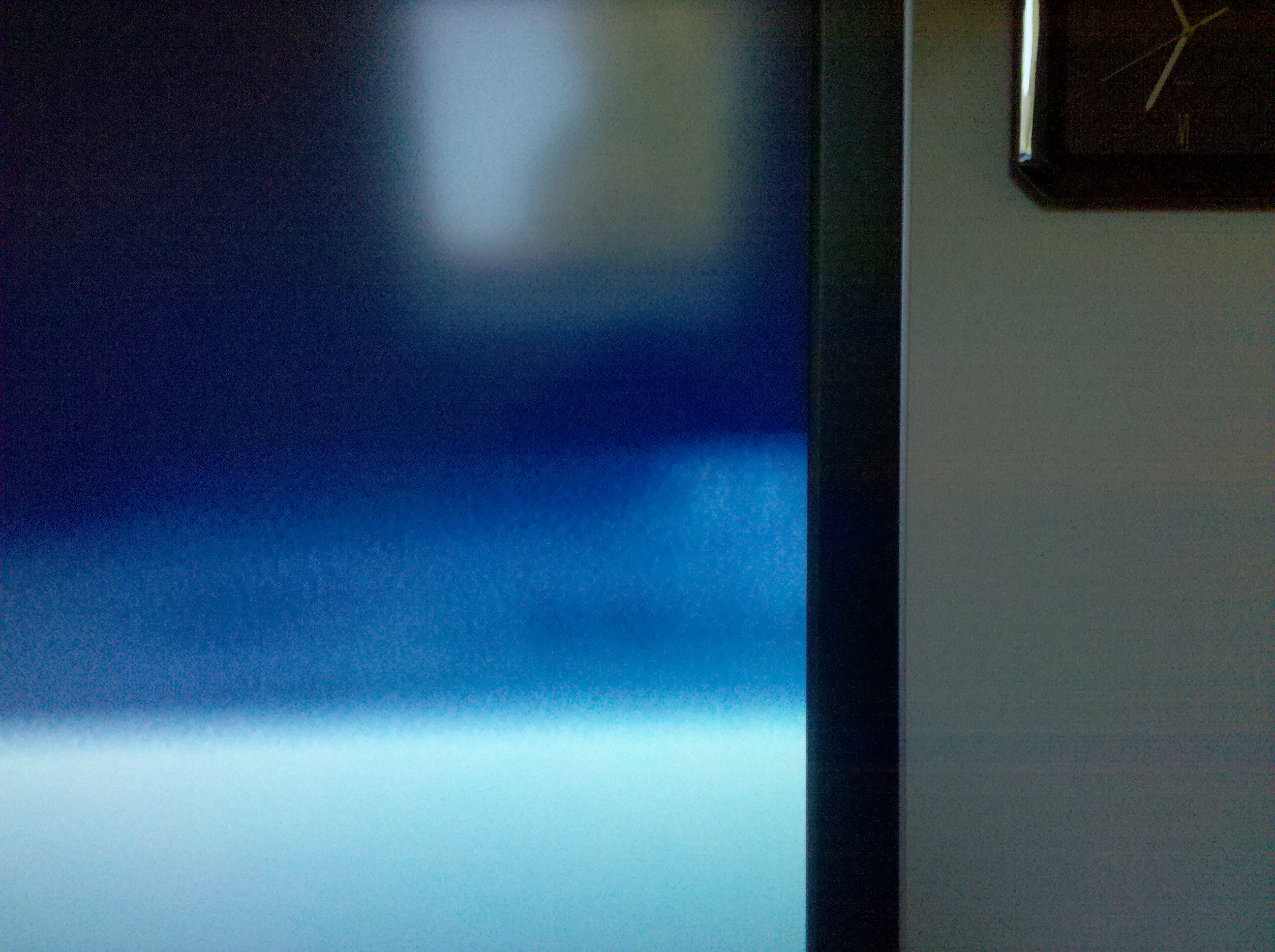

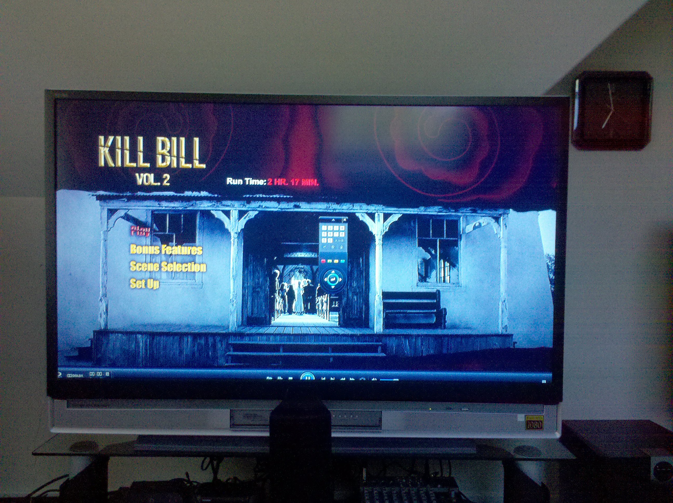

  1. Hi all, not sure if this is posted in the right area or not so please feel free to move if not. I have a Dell Sutdio XPS 8000 that I want to hook up to my TV via HDMI so that I can view my Blu-Ray movies from. The video card that came with the machine is an Nvidia GeForce GTS 240. It has two DVI slots on the back. I have one DVI slot hooked up to my computer monitor (Samsung XL2370) and the HDTV (Sony KDS-60A2000) hooked up via a DVI-to-HDMI with an HDMI cable running from the adapter to my TV.

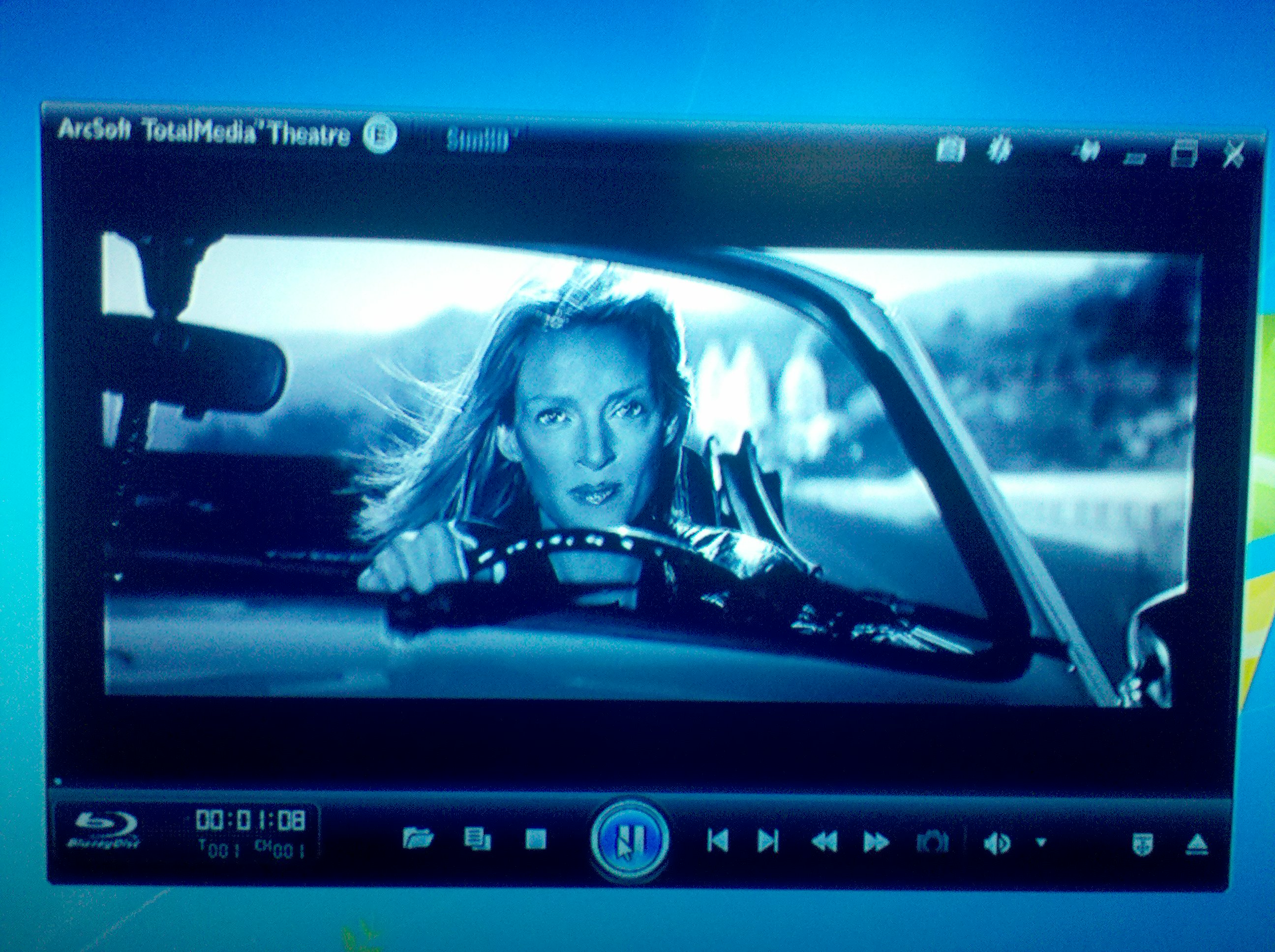

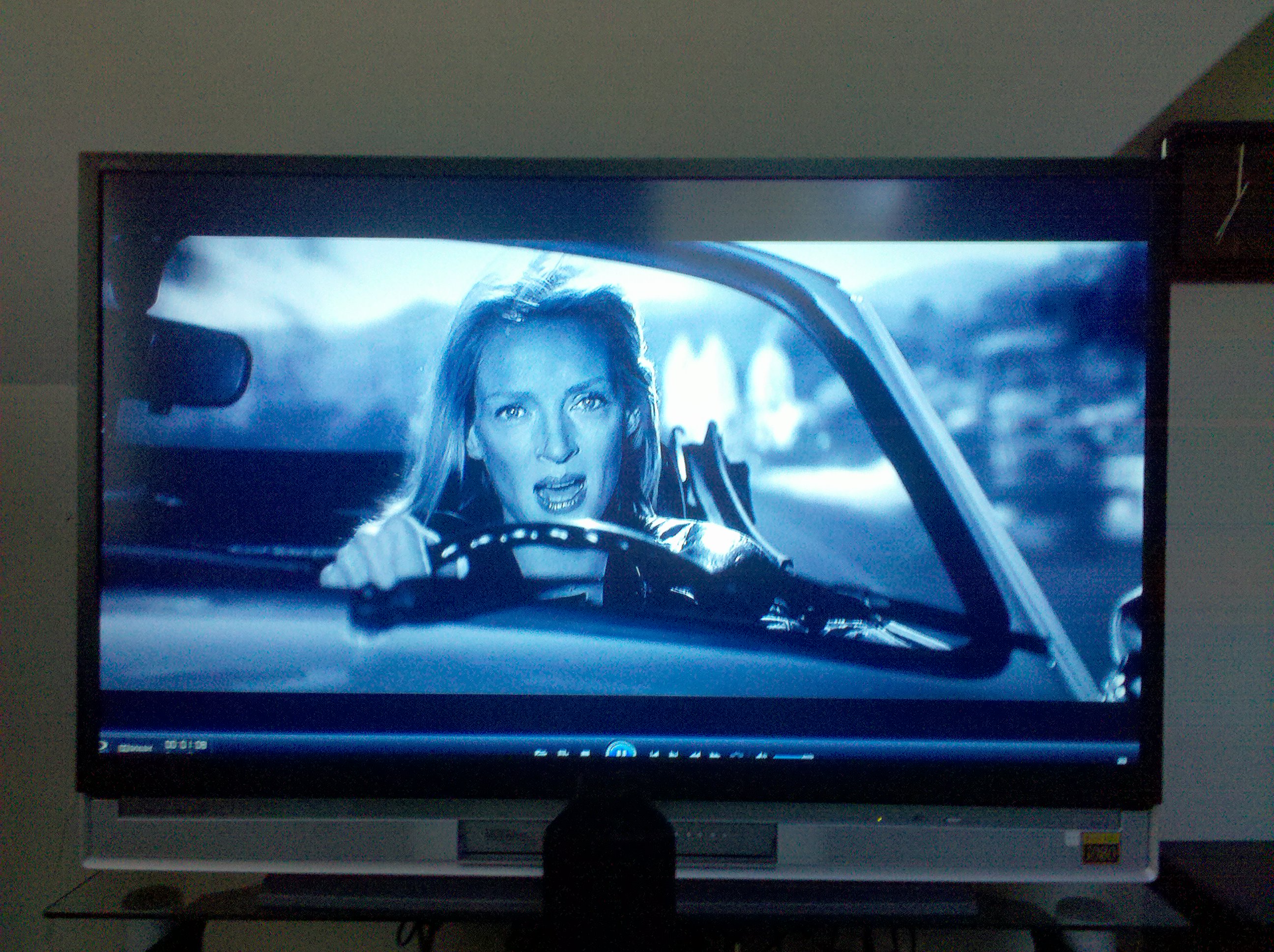

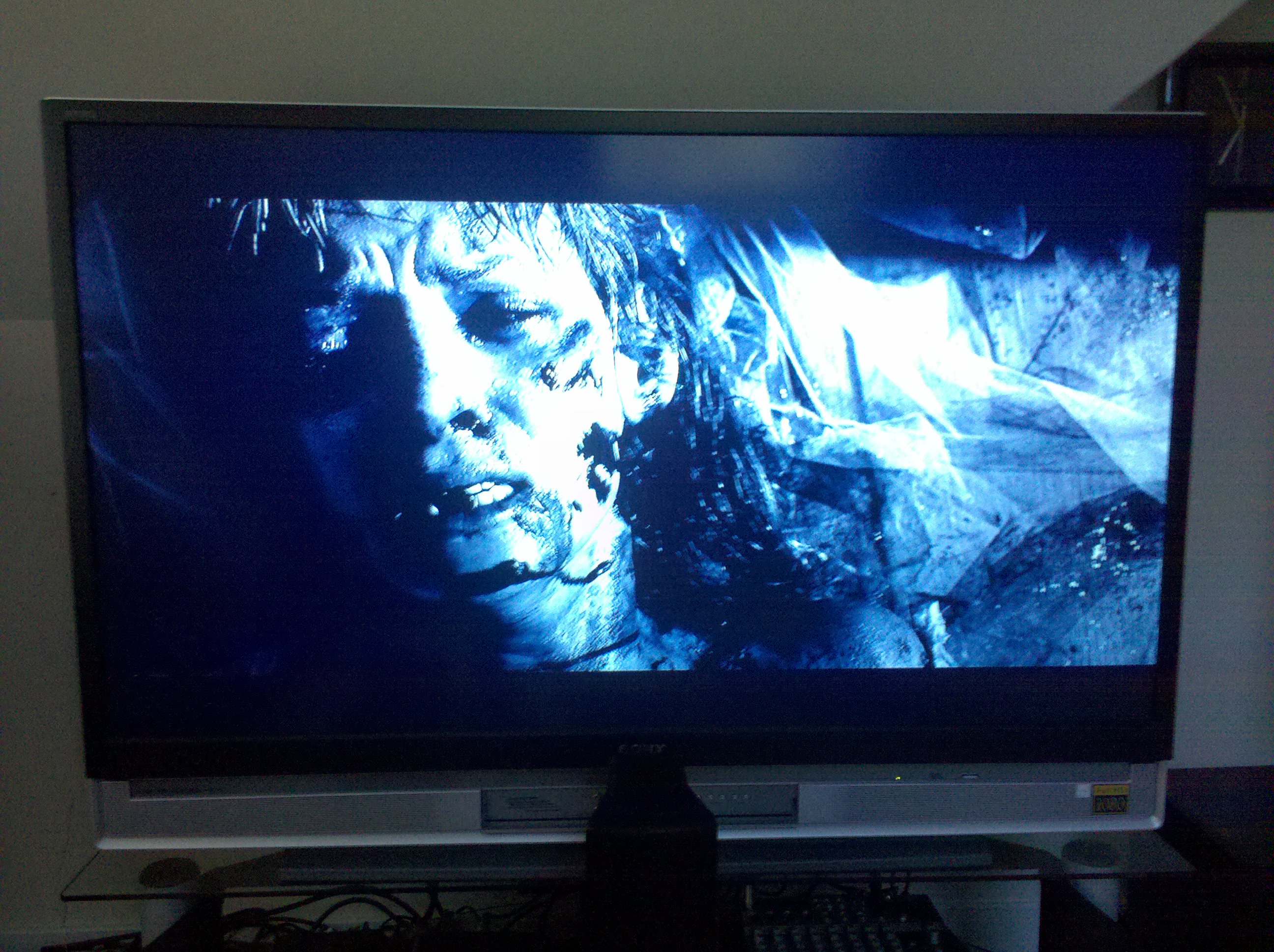

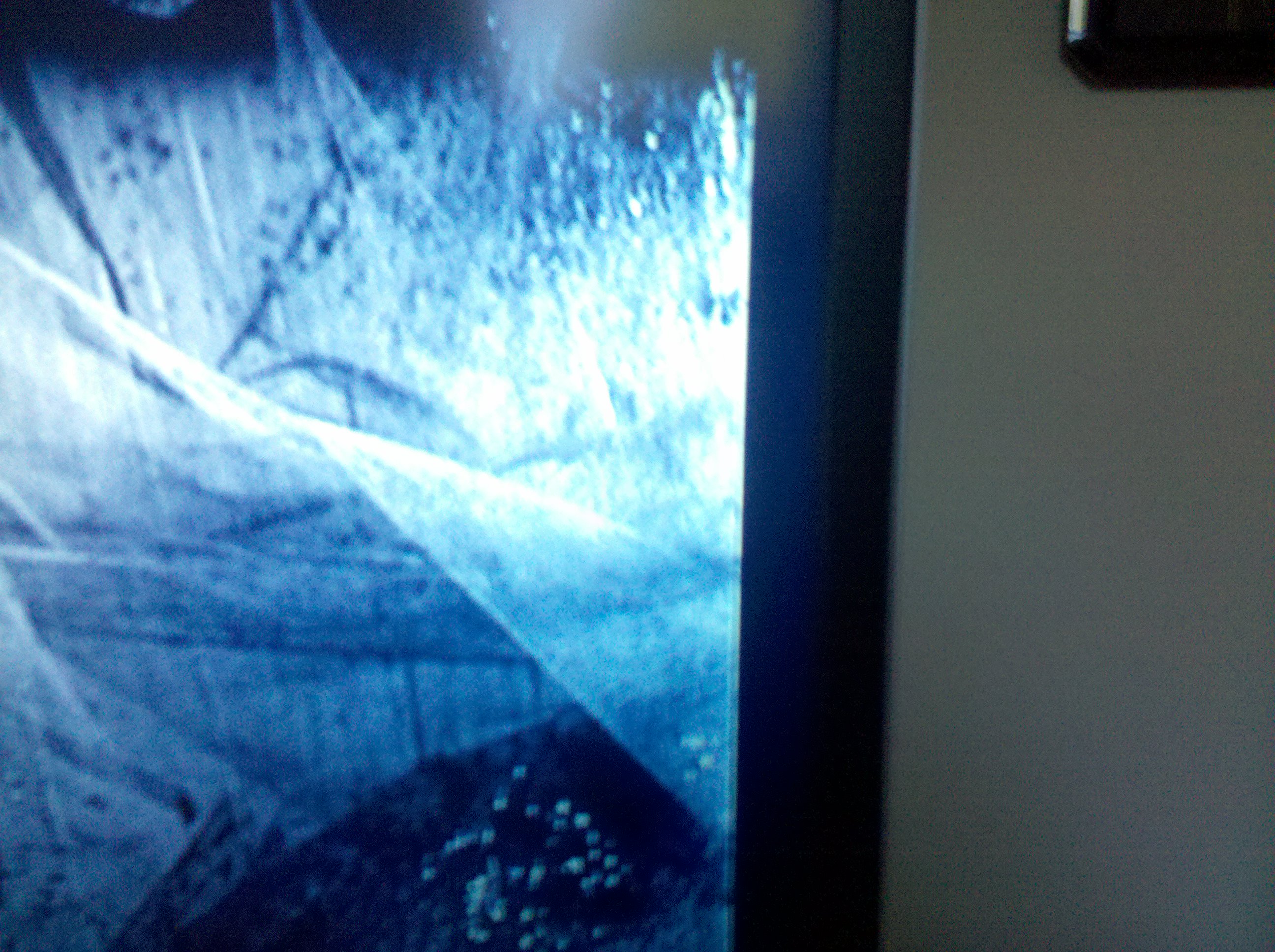

    The video feed is crystal clear, however, I can't seem to get it to display the proper resolution. With my resolution set at 1768x992, there's a black gap between the TV and where the video width starts (see attachments). The next higher resolution is 1920x1080 and when I set it to this resolution, it seems to lose a bit of the top and sides of the video (also in attachments). This is evident as I've taken a screenshot of the same scene at full screen and at a smaller screen. There is more to the sides of the video and I'm sure just a bit more at the top that aren't being seen in full-screen mode.
    I've tested the same BD with my Blu-Ray standalone player and the resolution is completely fine. The width of the video stretches to the outside edge of the TV like it is supposed to.

  2. TV's overscan the picture by default. They hide the outer few percent of picture on all four sides. This is because there is often junk out there. And since broadcasters know you can't see the edges of the frame they don't worry about leaving junk out there. It's a vicious circle.
    Your TV may have a non-overscan mode. Samsung calls it Just Scan. Other's call it Pixel-for-pixel or other terms. Set the computer to output 1920x1080. With the TV in pixel-for-pixel mode and the computer putting out 1920x1080 you will have the best possible picture.
  3. Thanks for the quick reply. If you look at the two pictures of Uma driving the car above, there's quite a bit cut off noted by the beads that hang from the rearview mirror and also a bit cut off from the side mirror on the driver's side. I don't see any option for pixel-for-pixel mode on my TV. Is there a way to fix the overscan from my PC?

    Hmm you're right buddy. When playing the BD through Arcsoft and sending to my TV, it seemed like I was missing some stuff on the sides (evident by the beads) because I saw more when the video was not in full-screen. When I played the same scene through my BD player however, it cut out the same amount of screen that was to the left of the beads. Thanks for the help!
