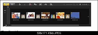

  1. So frustrated. So, I am editing my video clips and they all snap together and snap to the beggining! I do not want them to do this, I want them to have spaces so I can move them around freely until I am ready to put them all together. I am sure there must be some kind of snapping option, but I do not know where and I hope someone can help me.

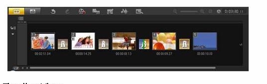

    you would like to see snap shots like this? if so, you can see left top corner yellow shaded button.click on that, you are done. click on the clip then drag wherever you want on time line.
