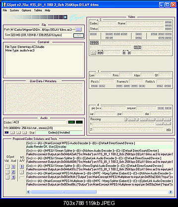

  6. Hi hech54
    I alredy have GSpot.
    Below is a screenshot of first VOB.
    [Attachment 2393 - Click to enlarge]
    On the bottom pane (Proposed codec solution and test), Audio Button 2 gave me the screenshot above. There is a line where we can see:
    "failed to connect Output pin 0x0987c344("AC3") on MMPEG-2 (demultiplexer to input pin 0x08bce994("Stream1") on filter 0x02b7a89c("Gretech Audio Filter"). ConnectDirect() failed. Error 0x080040207. [unknow]"
    (screenshot show just the begin of that line.
    When I press MS A/V button 1, the audio line is:
    "(Src)-->>--(A)-->[Demultiplexer MPEG-2]>--(B)-->[ffdshow Audio Decoder]>--(C)-->[Default DirectSound Device]
    If you need more info, let me know. Anything to fix that anoying of no audio thing.
    Tkx

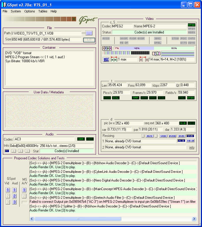

  10. Thank you jimdagys. I don't know what happend with my screenshot because at my computer Firefox open another tab and show correctly that JPG image.
    Now I change navigator to IE and try sending again.
    Sorry for any inconvenience.

    looks like the k-lite codec pack borked another system. the problem is the "gretech audio filter" whatever that is.
    Jan 2007
    Republic of Texas
    The problem is not that you don't have the proper codec installed. The problem is too many conflicting codecs -- a typical problem with codec packs. This is why a lot of us here warn against loading codec packs. Unless you know what you're doing, they can really bite you in the rear.

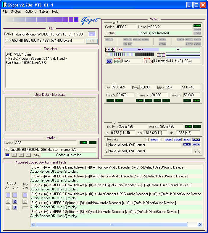

  16. Hi AlanHK
    Ok, Ok... You won. I reinstalled K-Lite 5.90 with default options. After that I uninstalled Gomplayer from the system. No problem because I have image file created with Ghost to retrieve all my olds settings when things goes wrong. Then, let's scramble my system for real.
    I run GSpot again and that error had gone, that one with Gretech Audio filter. See new screenshot below:
    If you need more info, let me know. I'll get it. I have to fix this problem and understand a little more about that. Nonsense -> PowerDVD can run sounds and nobody else can do it...

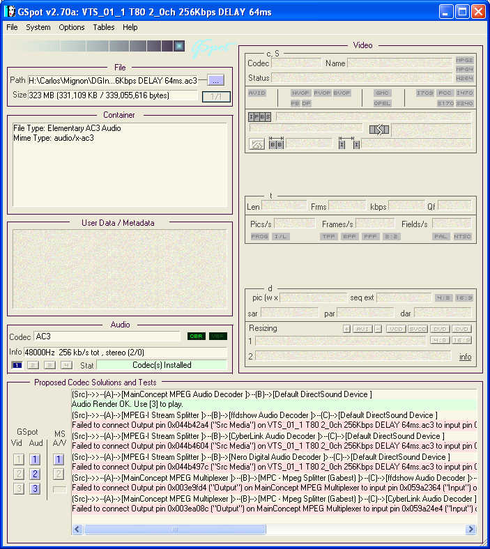

  17. I forgot to say: I used Audacity 1.2.6 (stable version). When I try to open VOB file it begins to do it and show progress bar.
    After few seconds, progress bar stops and ETA starts to increase, showing that something is stopped. I tryed with all VOBs of the movie and got the same result.
    I also tryed DGIndex but AC3 that came from its demux got the screenshot below (as you can see, too many problems):

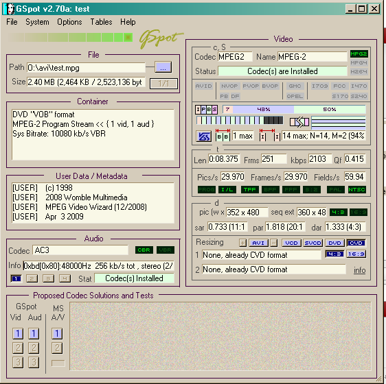

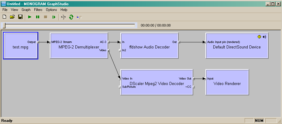

    Your mpeg plays fine for me, in MPC.
    Below are 1) my Gspot report of your file and 2) GraphStudio rendering the same file (you should find this under "Tools" in the K-Lite section of your start menu; or install it separately).
    That shows that it's just using ffdshow for the AC3.
    If you don't get that, try opening "ffdshow audio decoder", a config tool which you should find also in your start menu, and then "DirectShow control" and see the "merit" slider. Mine is on "ffdshow default". If that's what you have already, try pushing it up to the max, "very high". Then it should be the preferred decoder in MPC and most players.
