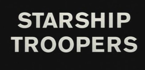

    Generally, I find the image quality to be comparable between rips of the same movie. However, I have noticed that there is significantly more "noise" or "artifacts" around text (such as credits, etc) using xvid than with x264. Why is that? See end of the post for a screencap of a movie encoded with xvid.
    (alternatively, click here: http://i424.photobucket.com/albums/pp325/Nyriador/Screencap1xvid.png )
    See the artifacts around the text? It was a lot less noticeable in the x264 version (which I unfortunately destroyed, so I can't really post it for comparison. I really should be less impulsive...).
    So, my question: Why would there be more "artifacts" with xvid? And is there a way to diminish this?

  2. So, my question: Why would there be more "artifacts" with xvid? And is there a way to diminish this?
    Those edge artifacts common to xvid are compression artifacts and DCT ringing
    x264 encoder offers much better compression. This implies at a given bitrate, it will be higher quality than xvid (if used properly)
    you cannot compare "quality" if the filesizes are different. This means they use different bitrate because filesize=bitrate x running time
    you can play back h.264 in PS3 , just remux the container to mp4 (e.g. use YAMB or mp4box)

    Just out of curiosity : the filesize of both files is almost the same (the xvid one is smaller by about 150 mb, and we're talking about roughly 2 gb files). I'm going to assume this just proves .h264 is superior to xvid?
  4. You can do a search , there are many many comparison threads. It's not even a debate. x264 is vastly superior to xvid in every way (even encoding speed for a certain level qualilty if you have an i7 or better cpu). Even hardware support for AVC is better than xvid these days (e.g. portable devices, phones, media boxes) - it used to be sparse for AVC
