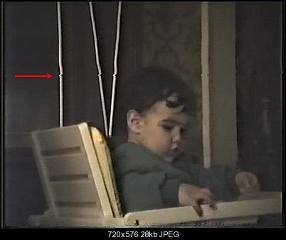

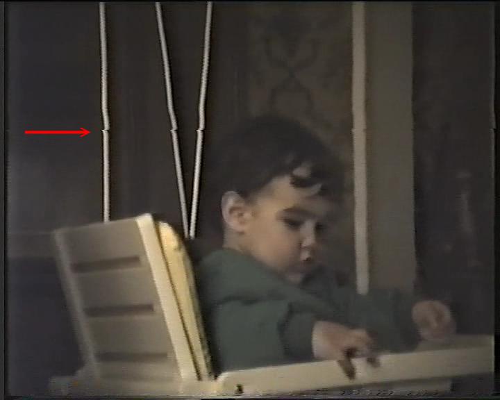

  3. Do you mean the problem the red line is pointing to?
    Those are time base errors -- from the recording or playback head not maintaining perfect playback speed, or maybe some defect on the tape. A line time base corrector should take care of most of it. That means a good S-VHS deck with line TBC, or an external TBC like in the Panasonic ES-15 DVD recorder.
    https://forum.videohelp.com/threads/319420-Who-uses-a-DVD-recorder-as-a-line-TBC-and-wh...=1#post1983288
    If you're talking about the junk at the bottom of the frame, all VHS tapes have that. All you can do is mask it or crop it away.
