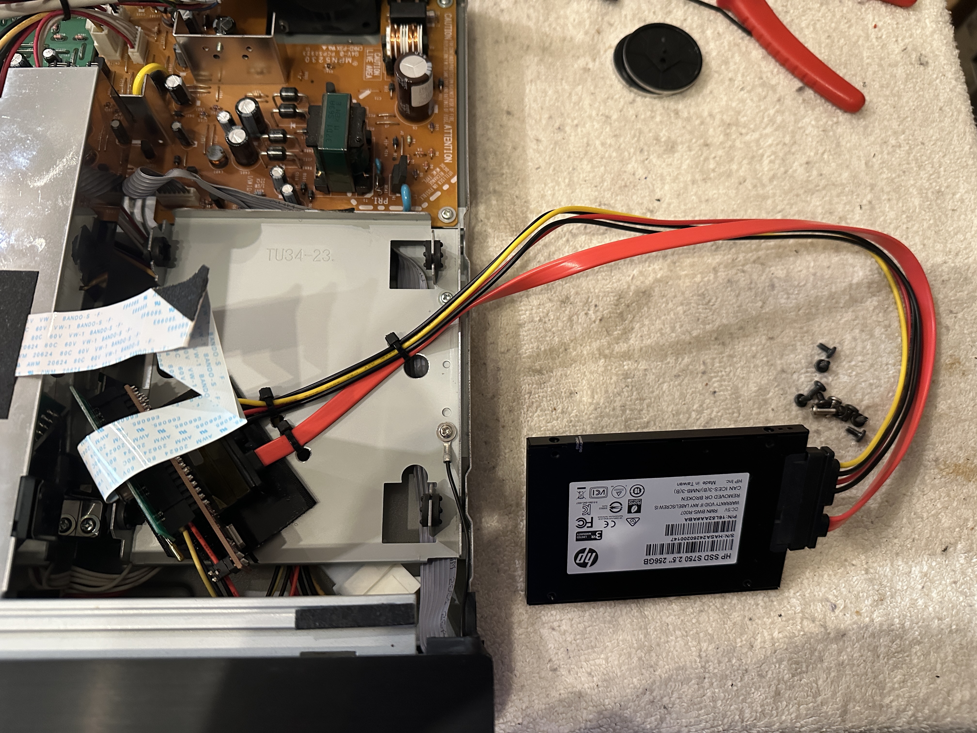

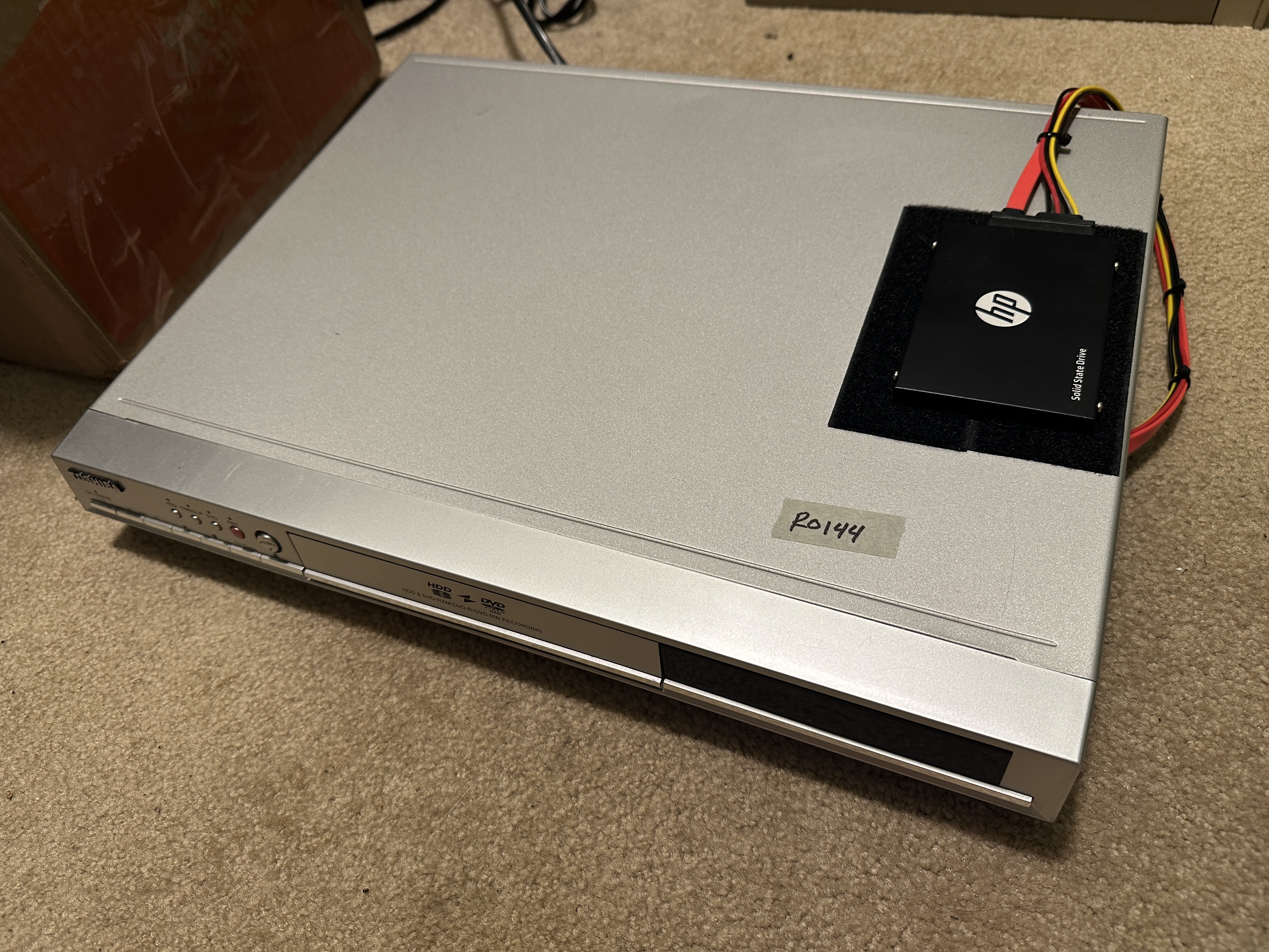

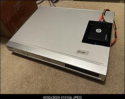

    As far as other standalone devices that might be better supported by modern systems, I've heard good things about the Dell Angel and apparently it works with any modern version of PowerDirector (though bitrate is fixed at 8Mb/s - which should still be fine) and Nero Vision (no idea how new of a windows OS that can be). The Dell Angel uses a similar or same NEC chip as at least some of the the RD-XS series.
    The Dell Angel also supposedly works super well with Snappysoft Monsoon which is XP only, but there's no way to buy a license these days as the company is long gone. Supposedly it was super easy to get around activating it according to those that used it back when it was more popular, but I don't see anything online for how you'd use what is essentially abandonware at this point.
