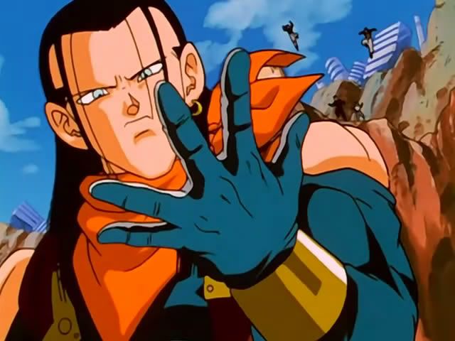

Hi. I was looking for encoding software that supported video filters and just happened to run across MeGUI. I know very little about AviSynth scripts but I'm learning. I found several tutorials and guides on writing scripts. Getting to the point. This pic below was taken from an encoded Dragon Ball GT episode with the following specs:
20 min. 44 sec.
MPEG-4 AVC Video
3 Audio Streams (AAC, 2 CH, 48 KHz)
640x480, 23.976 fps
File Size....... 96.4 MB
Basically.. I want to encode like this guy lol. I used to encode anime a while back using Handbrake. Handbrake simply cannot touch this level of quality (with such a small file size) and it does not support real video filters. I have no idea who did this nor what program they used but I am certain MeGUI can pull it off as well. What settings and filters do I need to use to achieve this level of quality for a 22-24 minute video? The file size can be anywhere from 90-200 MB. Or at the very least, tell me what kind of filter(s) makes your video look like this...

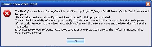

Nope. It crashes vdubmod v1.5.10.2.can you open .avs file in vdub ?
Yup. The .exe is about 2.98 MB.Did you do full install of avisynth?
Yar. Ver. 1.5.8.0.
Tried it with and without loadplugin. Same errors.otherwise you have to LoadPlugin("PATH\dgdecode.dll")
I get that error no matter what I do. It doesn't matter what's in the script. Now it's saying "Problem in Avisynth Script. Attempted to read or write to protected memory. This is often an indication that other memory is corrupt."Last edited by Nagashi; 21st Jun 2010 at 13:33.
I've never seen that error message before
maybe you have a bad memory stick?
try running memtest86+ or other memory integrity programs
Try rebooting
Did you create the script in notepad? Try copy & paste into notepad, save, then rename .txt extension to .avs
Also, be careful about adding that high of a saturation (i noticed you added tweak(sat=1.3) - it will override gradients and obscure lines. This source is already very saturated IMO. I added a screenshot in a zip file comparing to illustrate (comparing original script and if you added tweak(sat=1.3). - you can notice the shading is destroyed
I highly recommend you use avsp to monitor your previews and see what the script and filters are actually doing - this is how you learnLast edited by poisondeathray; 21st Jun 2010 at 13:44.
If you are getting errors from any script, it's probably something incompatible in your autoload plugins folder. Did this problem start around the time you added a bunch of new plugins?
Try emptying out the folder (apart from the standard DirectShowSource.dll) and copy them in one at a time until you find the culprit.
If you post a list of the folder contents here, perhaps we can identify something wrong.
BTW What OS are you running? -
This was before I started getting the error.Hold on, how can you preview it in megui if you get that error message?
Yep. I found the culprit.... It was FFT3Dfilter. Dunno why. I replaced it with another version and that fixed everything.Try emptying out the folder (apart from the standard DirectShowSource.dll) and copy them in one at a time until you find the culprit.
