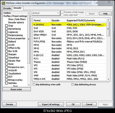

    Try this: since you have K-Lite installed, and I'm assuming it includes ffdshow, find the ffdshow folder in your Start menu.
    First, open "VFW configuration". Make sure "Codecs" is highlighted in the left pane, then find the entry in the right pane for "H.264/AVC" On my setup, it's the first entry, but it could be different for yours. Under the Decoder column, make sure it's not set to 'disabled'.

    Once that's done, close the window by clicking the OK button.

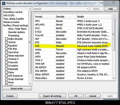

    Next, open "Audio decoder configuration". Select "Codecs" in the left pane, if it isn't selected, already, and find the entry for "AAC" in the right pane. Make sure the decoder isn't set to 'disabled', and click OK when you're done.

    After that, try re-encoding the video again with AutoGK (or even just open the copy of VirtualDubMod that's included with AutoGK, then load the video there and see if VirtualDubMod complains).

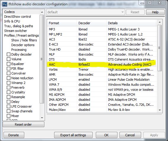

    uh, now we are getting somewhere In video encoder config I had those disabled. Enabled it now. But in audio decoder config when I select AAC, drop down box doesn't have any option to enable. Is there a special codec for audio? Really appreciate your help!
