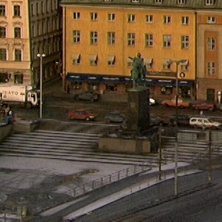

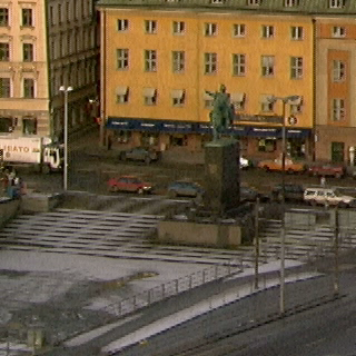

  16. Here are some examples of a panning shot, a 720p60 source, interlace to 720i30, then deinterlaced with various algorithms.
    A 720p60 source, interlaced to 720i30:
Size:  300.9 KB Name:  srci.png
    Simple bob deinterlace (I think this is what Vegas does), MPEG StreamClip:
Size:  300.9 KB Name:  mpsc.png
    AviSynth Yadif (VirtualDub's is similar), AviSynth TempGaussMC_Beta1mod:
Size:  300.9 KB Name:  tgmc.png
    Most videos don't have those very thin, nearly horizontal lines where most deinterlacers screw up. So consider these something like worst case examples.

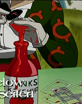

  29. Did you try VirtualDub's Yadif yet? Although it has problems with interlaced YV12 it will probably still look better than MPEG Streamclip. Here's an example where VirtualDub's incorrect handling of YV12 is very obvious (from a vertical panning shot), so you know what to look for.
    VirtaulDub's Deinterlace, Yadif, interlaced YV12 source (colors not aligned, stripes):
    VirtaulDub's Deinterlace, Yadif, interlaced YUY2 source (colors handled correctly):
    What a "perfect" deinterlacer would deliver:
    The problems are usually less obvious with real world video than in this animated source.
